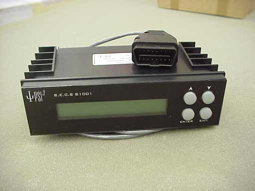

I've been talking with Quantum about a box they have for the WRX that mounts in a DIN enclosure. The only connection is to the ODB port and it uses the stock sensors to display boost, temps, speed, timing, etc. You select the 4 items you want to display - change them to something else if you want. It's made in England and supposedly they have a model for the EVO but none have shown up in the US so far.

From: Los Angeles
is that the S.E.C.S. unit?
Old Nov 18, 2003 | 03:02 PM
Dale_K's Avatar
Posts: 454
Right... here's a pic from the Quantum web site.

I have a PSI3 secs 1004 for my WRX - it's for sale now but, it was very nice! www.psi3.co.uk
Displayed all of the Data from my ECU, could read and clear DTC's , could hold peak values, could trigger alarms, could trigger a relay for nitrous/waterspray/water injection. Very nice unit!
I'll definately look into one of these for the EVO if Mark at Quantum will bring 'em in.
