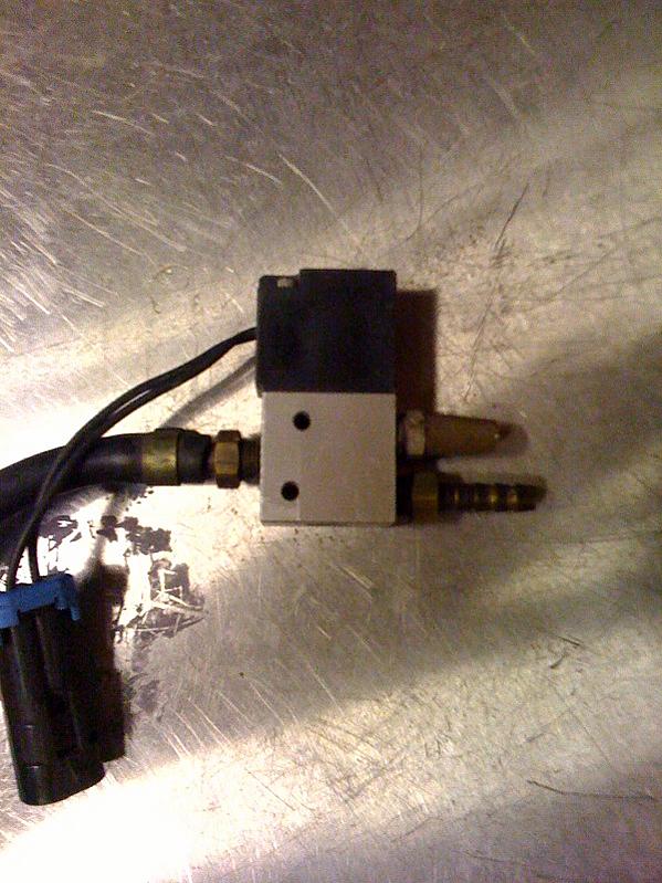

how did it work out? im also thinking maybe i can use this one although i cant identify it.just found it in my junk box lol. i think i used it on my grand national
