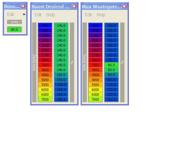

Originally Posted by Evo442
Would anyone who has had good results with stable boost using the stock boost control system be willing to post your settings? - wastegate duty cycle, bdel, correction values ...
These are my latest settings.
There's a slight jump from around 1.5bar to 1.55bar in the upper rpm range..... so I'm thinking of changing duty cycle at 6k rpms to 121 or so. But I'm actually pretty content so I may just leave it alone.
This is on a completely stock 05 with the restrictor pill at the solenoid removed. I have pretty significantly altered my timing maps because of the 91 crapass gas we get here in Cali. So you'll have to keep a very close eye on your knock count past 5-5.5k rpms.
I've been keeping track of the boost pattern with my Defi gauge and using the playback feature. If you're at, say, 4k rpms and floor it, it will spike to 1.6 bar (in ~65 F weather).

Originally Posted by burgers22
Hi
Thanks for the post. Have you verified that running the Wastegate duty cycle above 100 gives an increase in boost. I've not tried it yet, but would be interested to know from someone who has. Thanks.
MB
It definitely alters the boost. When I removed the restrictor pill, the boost spiked to 1.7 bar! That's why I have the duy cycle set to 80 in the 3.5k-4k range. I tried to manipulate the 'boost desired engine load' values to match with the actualy engine load at the entered duty cycle so that the boost is stable; basically, trying to get it close so that the correction factor is minimal. Of course, when you get to the upper rpm range, you end up maxing everything out to get the most boost.
On my car, the settings hold 1.5 bar through 6k rpms and drops to ~1.4-1.45 bar at 7k.
