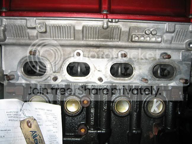

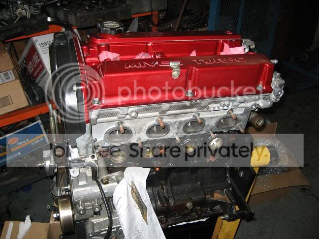

When it arrived i spoke with Gus, Sam, Rob and Chris about some options we can do. Engine looked pretty clean but who knows what kind of abuse it was involved in with the previous owner. I decided to have some peace of mind so we tore it down for some fresh new OEM belts, seals and gaskets. They sent the head in to the machine shop to have the cylinder head resurfaced, 5 angle valve job and Viton valve stem seals added. Serpentine Timing belt, Accessory belt and water pump were replaced. New OEM head gasket and ARP head studs were added.
Engine looked fresh and new and was finally ready to be swapped in.

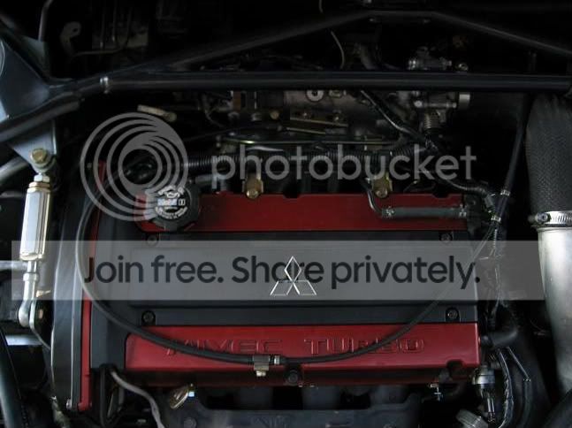

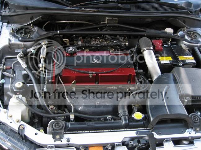

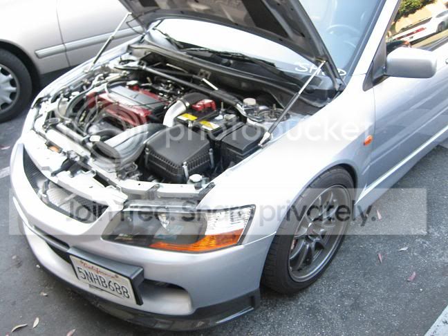

The swap took about 5 days for RRE to complete. Topped off with some redline fluids and she was good to go. Took it around for a spin and the engine felt, sounded and looked great.
Overall I couldn't be happier with my decision to go with MIVEC. I can't say the car is faster since my old setup had cams as well as a full exhaust but it definitely a lot smoother overall. I'd like to again say thank you to the whole crew at Road Race Engineering and the phenomenal work and service they provided me.
