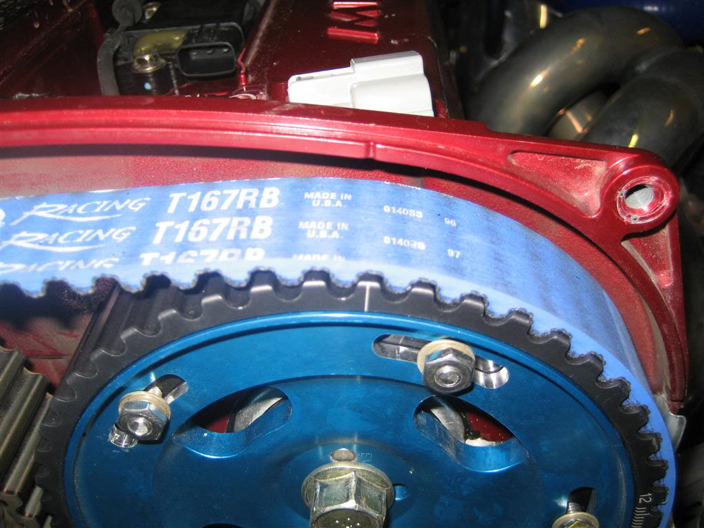

Okay, anticipating a possible massive timing change (like if the oil pump sprocket or balance shaft sprockets were off) I removed the accessory belt, water pump pulley, idler pulley, tensioner, passenger side engine mount and upper timing cover. Here is what everything looks like @ TDC....
So now what...
So now what...
The adjustable cam gear has the exhaust cam slightly retarded, but nothing along the lines with bending valves I would think. I have seen timing off by a tooth or two with still no issues. Are you sure you installed the cams correctly? Did you degree the cams in or just throw the adjustable cam gear on there with the cam and then the belt? The timing light will tell you what the true timing of the motor is, but to me it looks okay to begin with there. The Crank is at TDC as well as the MIVEC and the exhaust cam is less than a tooth retarded. Nothing terribly wrong so far.

My friend (Master Tech with Mercedes) is bringing over his timing light tonight to see for sure. I purposely retarded the exhaust cam 1* to add more overlap, hence the installation of an adjustable cam gear. And the cams can only be installed one way - with the dowel pin up. If I tried to install the cams into any other rotational orientation, I wouldn't be able to get the dowel pin into the cam gear (as the photo shows for the exhaust cam gear). So I know the cams are installed, at least rotational, correct. I'm just waiting now to see what the timing light shows and the compression test...
Well I'll be damned, the cam sensor is indexed correctly and the timing looks to be dead on to me. It has to be something to do with the cam install though because she was not having issues prior to the install, correct? Timing light may help but with the issues your having I think it would be obvious and the timing is not off imo. Let us know what your buddy says and we'll take it from there
