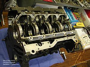

Engine Block
Block

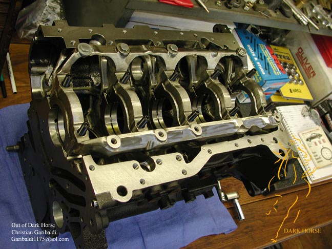

main girdle
main caps

what are you doing to it?
Old Nov 22, 2003 | 04:11 PM
darkhorse's Avatar
Joined: Nov 2003
Posts: 227
Pretty much everything. The block has been polished, squared and blue printed thus far. It was amazing to see just how bad the dimensions are in these things to start with. It takes a lot of time to get everythiing squared up in the block so that it can be considered a decent platform to start putting some real power on top of it. For stock use , its fine, but for serious upgrading and severe use, it will not last very long.

is the block strong enough with 2 bolt mains only??
Old Nov 23, 2003 | 05:24 AM
aaronyoung's Avatar
Posts: 71
From: baltimore
The girdle provides extra strength for the block.
Old Nov 24, 2003 | 04:04 PM
darkhorse's Avatar
Joined: Nov 2003
Posts: 227
Is the block strong enough for what? There is not enough room for a four bolt main cap in the block. We are working on alternative options to shore up the bottom end of these cars. True, the girdle helps, but the assembly is made from cast iron and is not very rigid, thats why they tied them all together. Like I said we are working on other avenues to adress beefing up the main cap area of this motor.

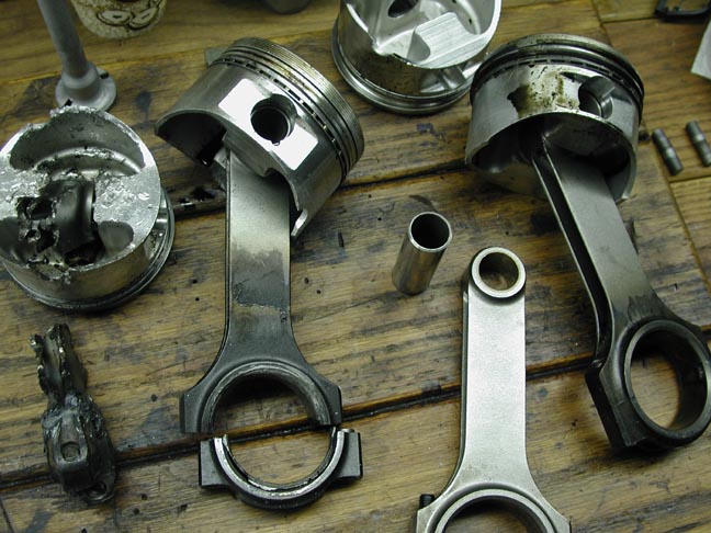

Old Nov 24, 2003 | 07:52 PM
n00dle's Avatar
Posts: 788
Are those the stock internals?
Old Nov 24, 2003 | 07:53 PM
darkhorse's Avatar
Joined: Nov 2003
Posts: 227
No, but the block was, and there wasn't much left of it to photograph.
