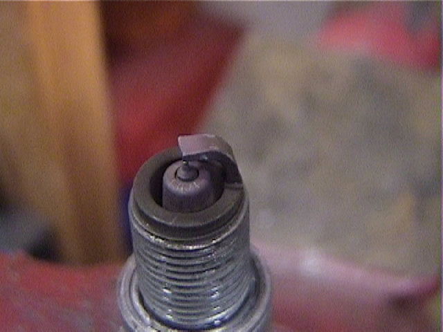

do you have any pics of those old foulded plugs?

You can actually see the carbon tracks on this one, this is with only about 50 miles since the last cleaning. With longer run times and heavier deposits it's usually not this easy to see the actual carbon tracks. Initially I was just getting a lot of missing/rough idle, after the fourth cleaning and the heavy tracking you see here, the engine would just fall on its face under high load, like hitting the rev limiter at 4-5K. I even went to my friends shop and let him take a crack at cleaning them with his plug cleaner.
