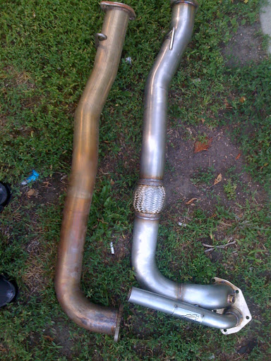

On Topic: Like I said we can take photos all day of this stuff off the car ill post pictures SUNDAY ON THE CAR!!! with measurements and clearence ect cause they all look the same plus or minus few things but fitment is key in everyones mind.
