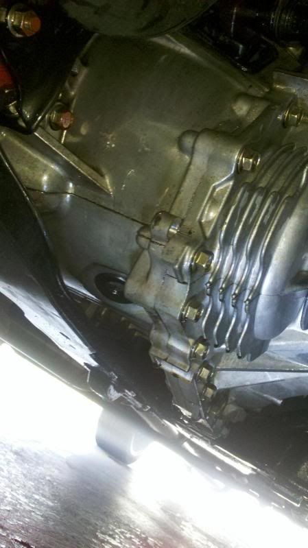

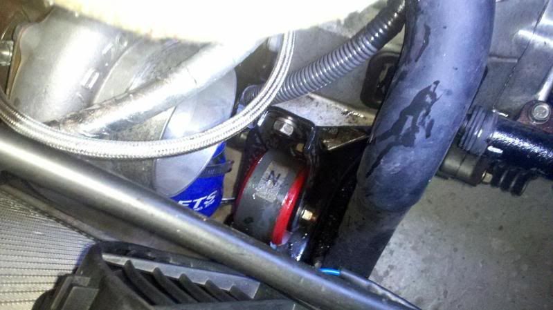

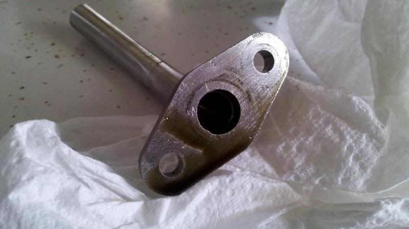

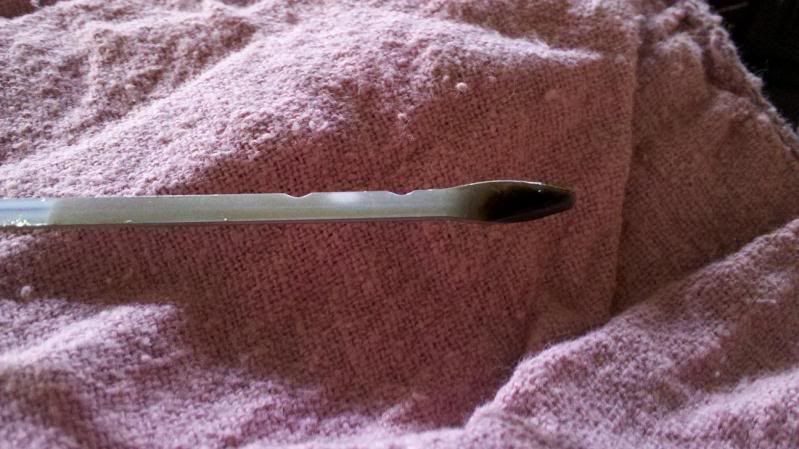

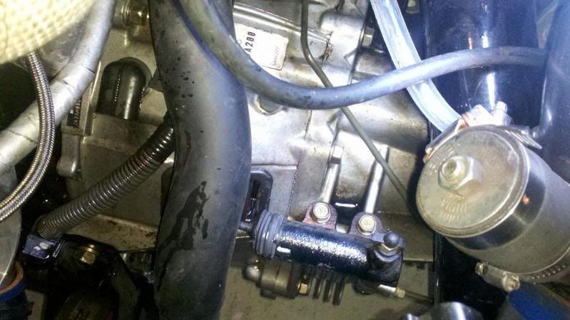

heres some pics:
oil return fitting as soon as i disconnected it from the oil pan. definately looks like it was leaking to me
heres how much oil is in the car now
oil sprayed all over the place
top/front of trans
near turbo
bottom of trans

car is fixed. it was leaking oil out of the feed line at the banjo bolt (not the bolt itself, but where the line screws to the banjo fitting) and the oil return line was leaking at the fitting that connects to the oil pan. i ended up making my own gasket and it solved that problem
