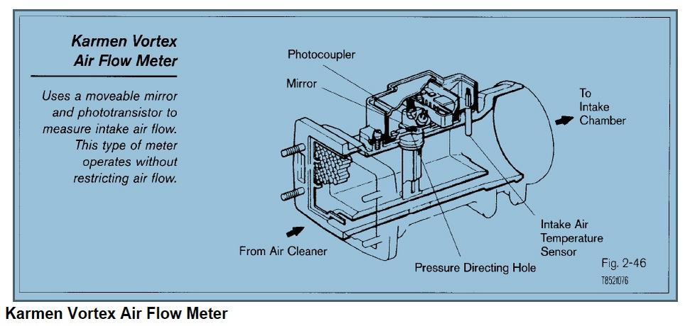

FYI the EVO has a "Karman-Vortex" airflow sensor
Originally Posted by zeus1
my question is does the evo (i have an 05) have a Karman-Vortex airflow sensor?
"10. DO NOT use on vehicles
with a Karman-Vortex air flow sensor, e.g. Toyota
Supra Turbos, Mitsubishi’s and most Lexus
vehicles."
http://www.crcindustries.com/faxdocs...on/st05110.pdf
