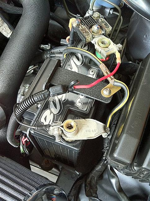

Installed the buschur cdi last night. I took it out as soon as I had put it on. Pulled nice and smooth, idled great. This what at 32 psi. Then go to sheetz and put it at 35. Go to get on it and it wouldnt pull smooth, sounded like a two step untill I let off the gas pedal. I turned it down to 30 psi and it's still doing it. The plug look fine, took them out last night. Needless to say I had a sparktech non cdi before i installed this and it ran great, thats why Im baffled about this. I should have plenty of spark with this reliable ignition. So I am picky my brain to try to think whats wrong. I want to know what you guys think. I am on the stock plugs for my 9 i cant remember if they are gapped to 18 or 22. During this install I was unsure off where the two wires from the harness got hooke. I thought the black on the negative and the red on the positive. Tell me if this is correct in the picture please

Wires at battery are correct. Borrow another ignition from someone to see if it goes away.
