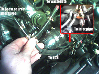

You should have a Y there. One side (with the red color at the tip) attaches to the wastegate, the other side of the Y connects to the boost source after the turbo, The other end of that entire hose connects to the plug on the stock boost control soleoid (the plug closest to the cockpit) and then the other nipple on the BCS connects to a short VAC hose that connects to the turbo linlet pipe.

Maybe this will help
