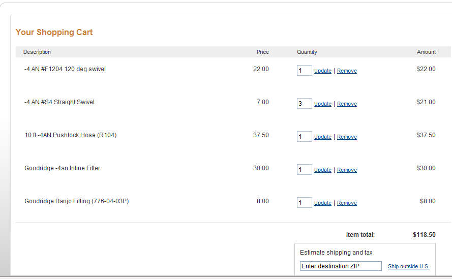

Ok, I have been looking around and I have two last questions:
Do I need a restrictor of any sorts to run oil off of the filter housing for the turbo?
Is the turbo m10x1.25 correct?
heres what I have so far, the only thing I dont have is the oil housing adapter.
Not familiar with 3/8bspt, so I gotta do a little more lookin
Looks like it could be done cheaper, but at the same time my quick list here is half of what FP wants! youre just roped in to using the FP line if youre worried about thier particular debris warranty... kind of ehhh
Old Aug 23, 2011 | 05:49 PM
1UpMoto's Avatar
Joined: May 2011
Posts: 398
From: 305
After you get everything together and are sure all of the parts are correct you should write a how to with all of the part numbers, because I was thinking of doing this myself and I am sure a few others are as well.

Anyone know where to get the 3/8 bspt? Or would using the prosport sandwich adapter provide oil enough?

I can't find the bspt to an -4 straight fitting. Fp sells a 90° but that won't work as well
