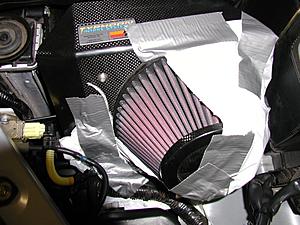

This weekend just installed a TurboXS MBC at 19.25 max boost, HKS DP, EGT guage, and SAFCII. We tuned it very conservatively... ran great (good boost and EGTs) for about 7 hard WOT pulls (just enough for the ECU to relearn), then fuel cut begins with no CEL. Finally after a trying to identify what the heck is going on with additional fuel cuts, it throws a CEL/SES. Had a friend run the code, P0234, which equates to boost solenoid malfunction and it appears the MAF is receiving too much air (logged 220% volumetric air) then dumping fuel to compensate since my factory solenoid is not connected. I do not think my A/F will be able to compensate enough for that much air!
Before I spend a ton of money with some O2 Wideband and Dyno time, I thought I would call K&N and get their feedback. I did so and spoke to one of their senior techs. He understood what I was telling him, but had not heard of it before (you guys need to call them with your problems which I will post on another thread), he recommended I try to restrict some of the air by closing off half of the intake filter outside with some material to see if it will reduce air volume. Going to try this tonight, wish me luck. If this fixes it...going back to the stock intake housing with a drop in and will call K&N back.

Well...that fixed it. Several hard pulls with no fuel cut. A garbage bag and some duct tape. Leave it up to old school diagnostics, heh!
Anyway....time to head back to the stock intake housing unless I want to drive around with this on. K&N did offer to send me a sock application which they use for extreme dusty situations that will reduce air instake by 3-4%, but I do not think this will be enough. Does anyone know if the S-AFC II can adjust for this much air, 220% volumetric?
