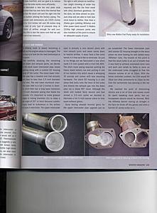

Here is a write up in a mag were they gained 15whp w/ the ams o2 housing and an intercooler pipe..
15whp is not bad...
Correct me if I'm wrong, but the AMS o2 is only 2.5" thats only .25" bigger than stock.

Originally posted by EvOmar
15whp is not bad...
Actually per the article it is 3" but the letters are kind of small after resizing so it is hard to read..
here is a link to the pdf of the article for easier reading
http://www.automotosports.com/mediapage/EVO_Stage_2.pdf
Right Click Save As
Do you have any more pics of that? Especially the mating side
of the flange.
The picture on the web is kind of small.....
Also are the flanges stainless??
Go to my post above that has the magazine page scanned and you can see the flange side, or DL the pages from mag from the post above..
hmm.. Kind of hard to depcit the quality of the o2 housing.
You never answered if the flanges were stainless or not.

if the AMS O2 housing is 3" why is there an extension for the donut gasket ? this is according to the pic on the web site

the one on the website is not 3", and I know that they will perform the same on a stock turbo'd car.
-kris
-kris
So the one in the magazine was a prototype or what???
