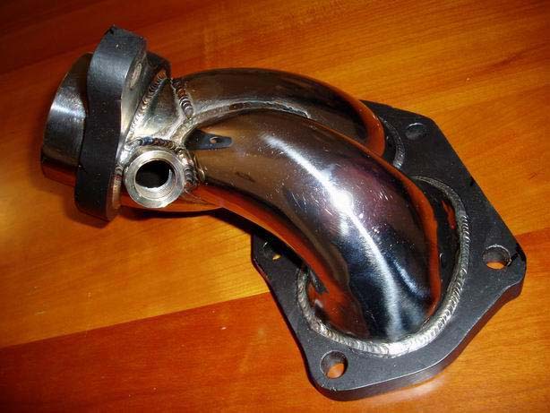

I also highly recommend the 3" 02 housings. We use all SS flanges, tig welded and the option of internal or external dump.
The price is $269.
If you are looking to get the best spool up and the most power from your stock turbo then this is the way to go. Just ask any DSM guy. 2.25" to 3" is a big difference.

Old Jan 17, 2004 | 09:24 PM
  #43
EvOmar's Avatar
Posts: 13
Originally posted by boiwunder
check out the new O2 housing that we offer, stainless construction with TIG welds throughout.
http://www.automotosports.com/evo_exhaust.asp
-kris
Do you guys fabricate those in house or do you purchase them from another source???
