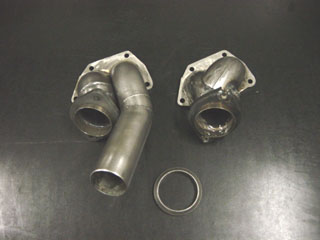

The stock Evo o2 housing is less than 2.25 inches at the exit. Thats not big enough if you plan on producing good hp numbers.
The guys at Gtfabrications.com have a nice o2 with or w/o an external dump which I plan on buying soon.

That sounds reasonable, although is there any actual dyno #'s or track number somewhere that would support that this or any other O2 housing would really help performance.
Also if you were planning on getting the dump tube how do you plan to get the pipe routed...

EvOmar's Avatar
Posts: 13
Joe
Like this
