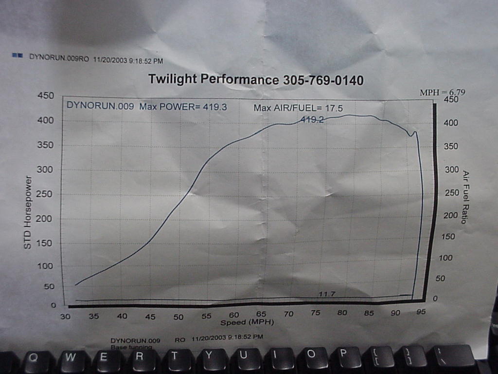

right...but why with the same setup...was my car just starting to make power there?

John here is your Dyno Chart.

Hmm, on my dyno the EVO's lay down about 230-236 whp on average. I have gotten as high as 330 whp on stock turbo and stock camshafts/internals/clutch/trans. This is just on 100 octane unleaded fuel. I expected at least a 100% increase in power out of the HKS 3037 kit. What did Al lay down without nitrous, anyone know?

a/f 11.7
boost 21 pounds

I respectfully disagree with you about the potential of the 3037s, something must have been wrong with that car or the dyno must read very low. I have a similar setup on my car, except my head is hogged out and i have bigger valves, balance shafts removed balanced rotating assembly pistons etc etc.. and with a conservative 21 pounds of boost on 93 octane I pulled 419whp on a Dynojet...( I know youre going to say dynojets read or calculate hp a bit more liberally) but why did you limit the car to 6000 rpm and blame it on turbo flow limitations, when I have shown that the car can still produce power close to 9000 rpm, is the bottom end not build on the car your talking about? if so I can see why, but thats then a limitation of the bottom ends ability to spin, and not the limitation of the turbo.
John we are making around 350-360 WHP on a dynojet with our Stage 1 + kits (Stock turbo@22PSI, XEDE, HKS Cams, Vishnu Cam Gears and full Exhaust) on pump gas. That is only 60 whp less than your built motor, 3037 turbo, 9000 redline etc, etc. The car also was not limited to 6000 rpms, it just stopped making more power above that mark. Good luck with your turbo search and let me know if we can be of any assistance.
