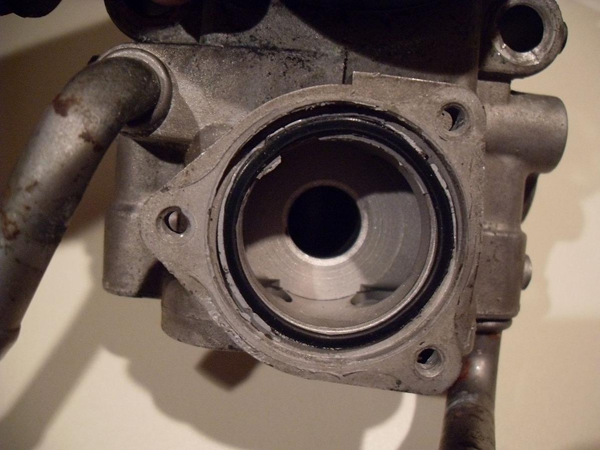

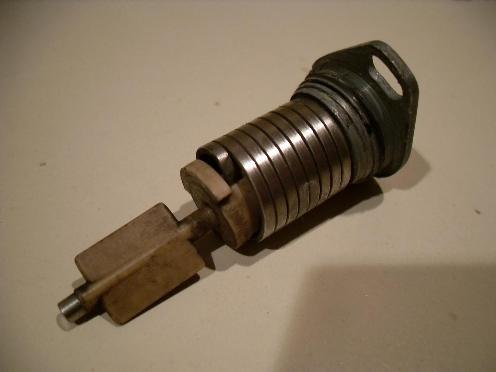

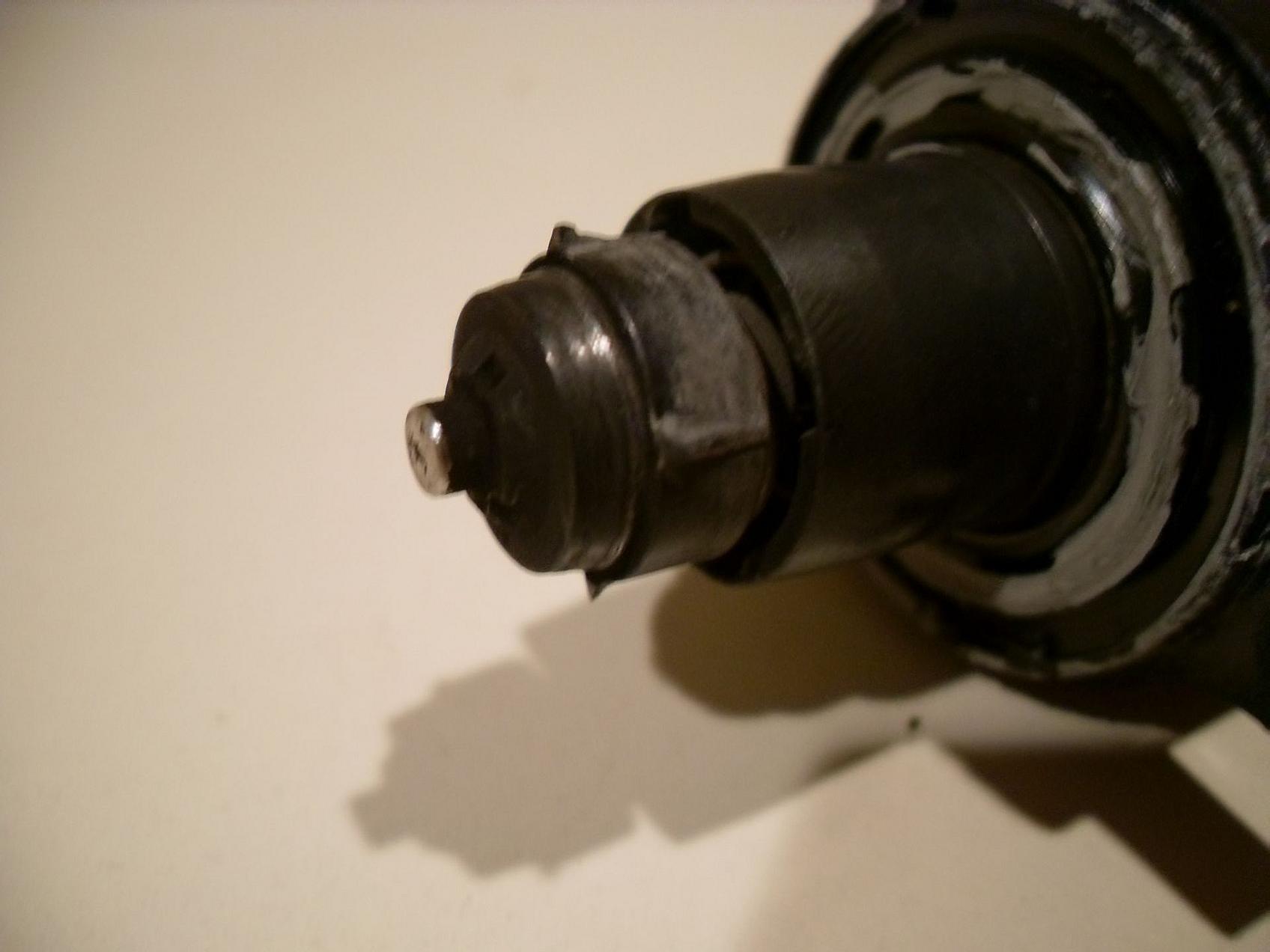

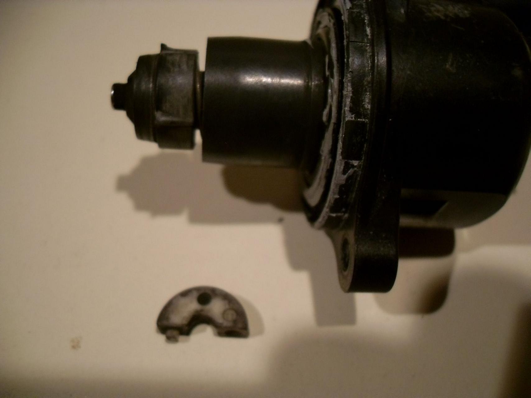

heres what i found
1st pic my iac does not look like any others I see googling or on ebay. The end looks messed up
2nd pic is what I found in my tb. plastic half moon. Not sure where its from
3rd pic shows where that piece was. In the center hole
4th pic I had to remove this guy to get the part out not sure what it does
the iac coils all checked out at 28.7-29.1 ohms. I think i need a new iac. not sure where other pieces are though
