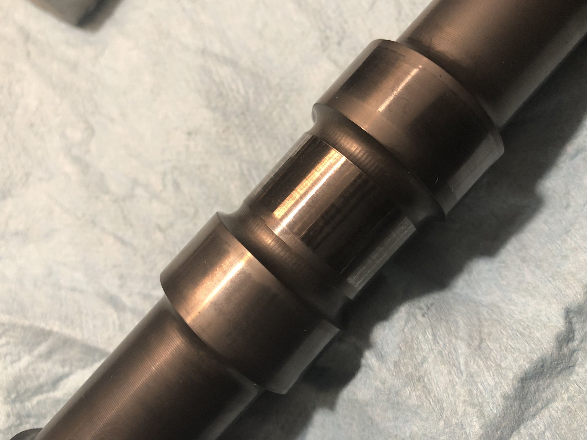

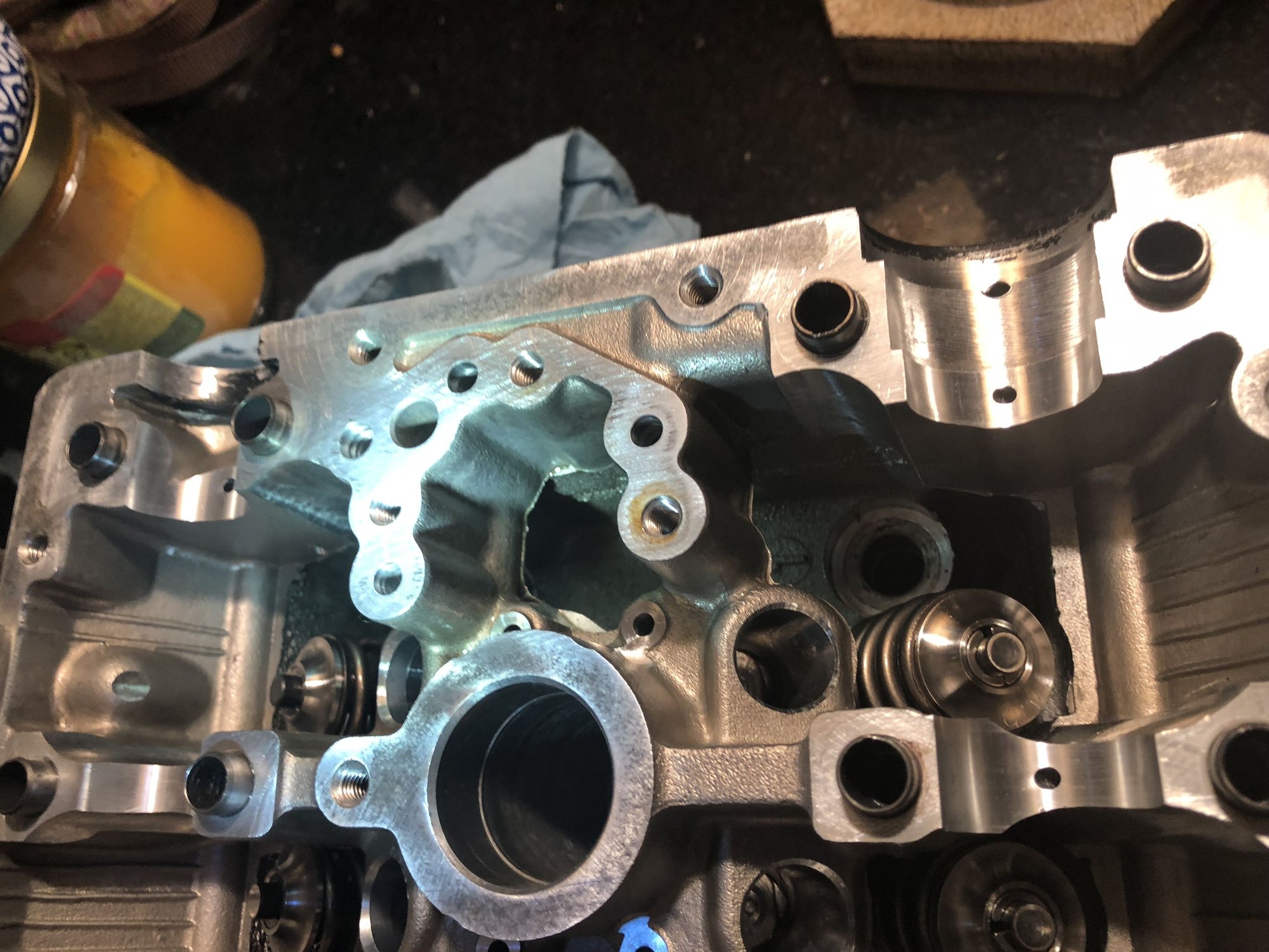

Did you ensure the cams spun freely in the head before going through with final install? Any time I get new cams, or a head back from the machine shop, I install the cams with assembly line and make sure they spin nicely without the rockers installed.

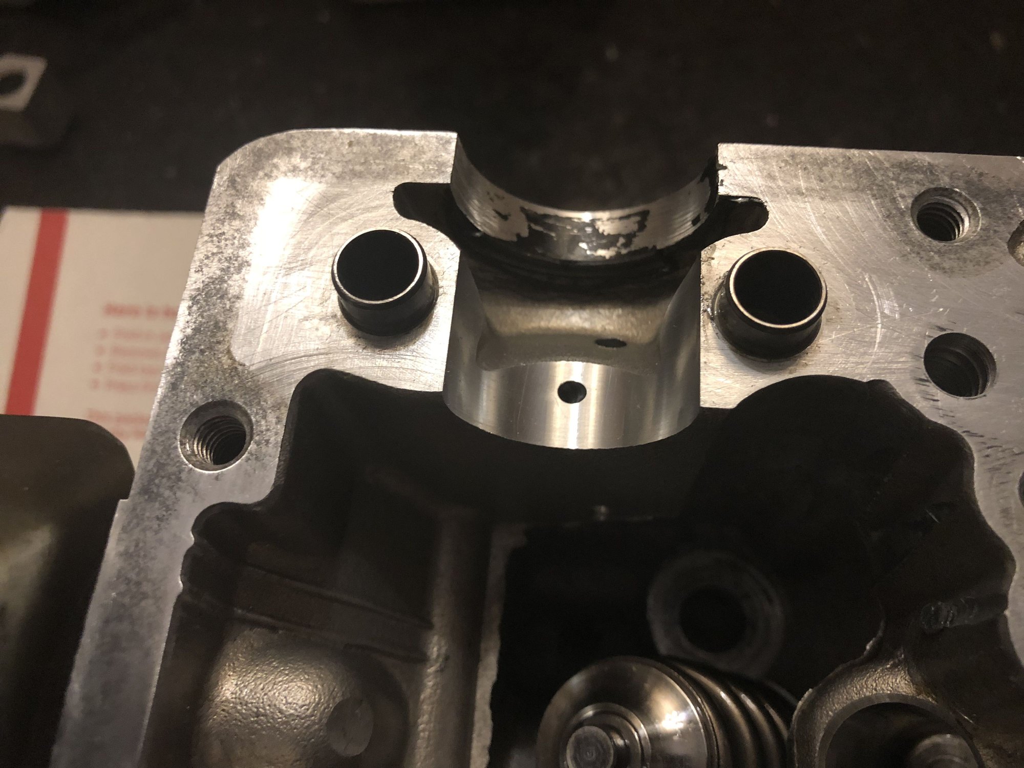

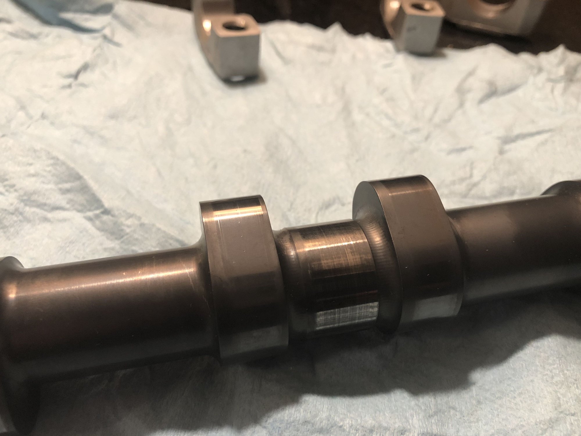

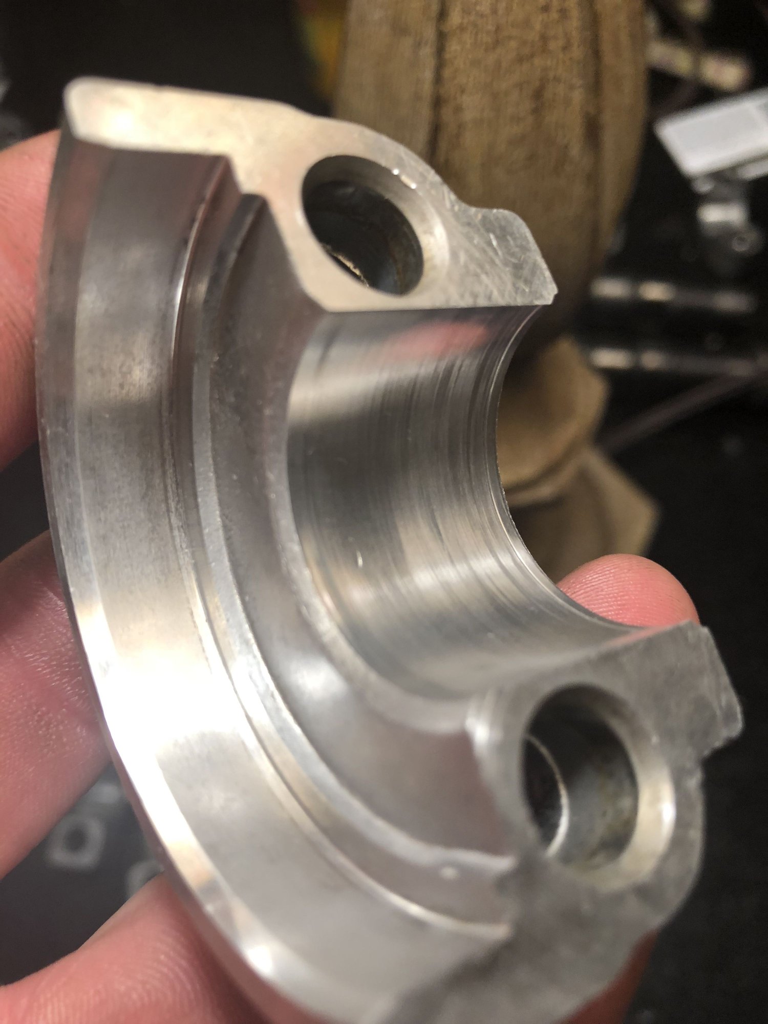

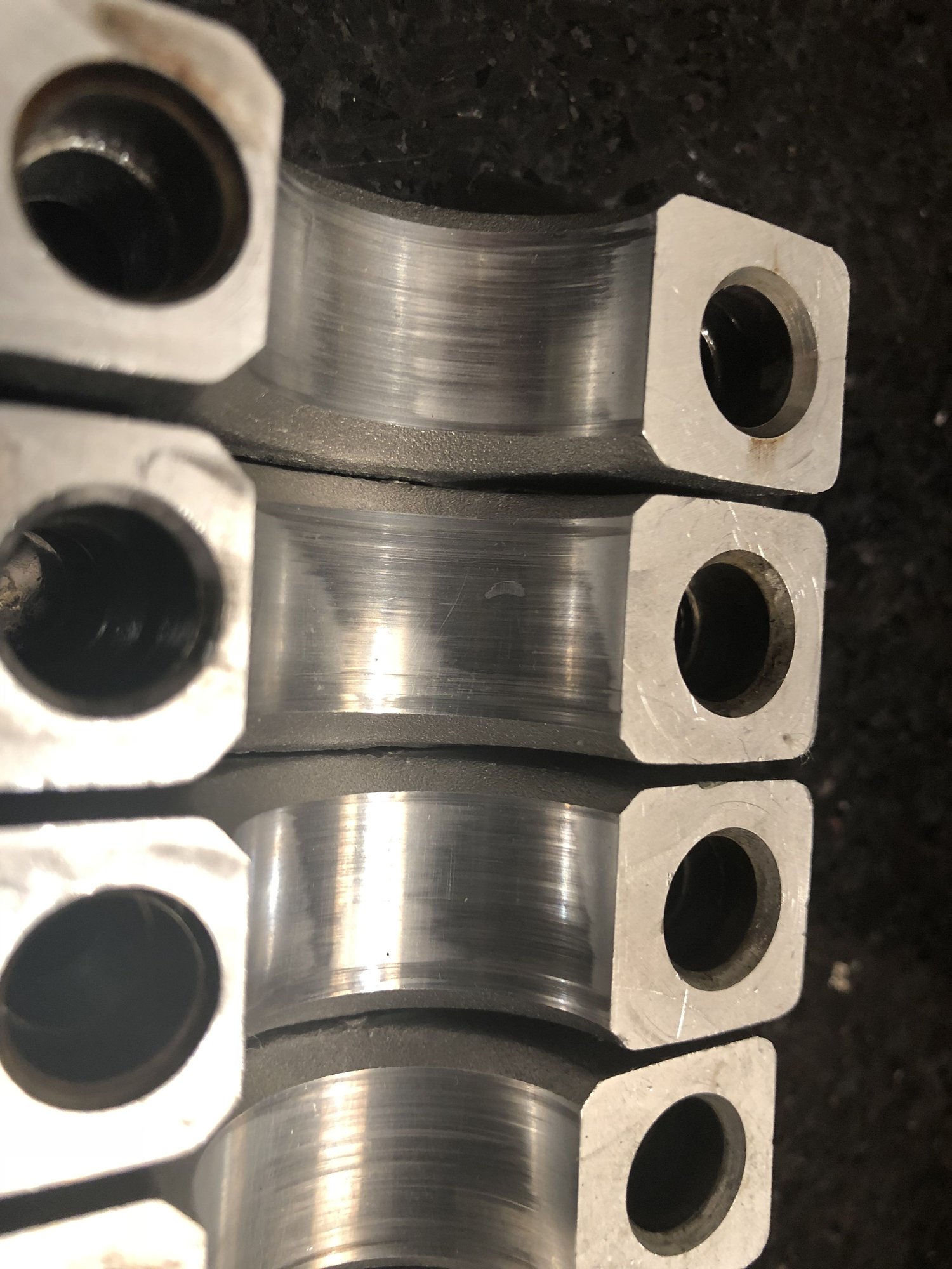

Did you bleed the lifters down?
That wear definitely isn't normal but as long as it doesn't catch a fingernail it can be polished out. Worst case scenario there are some shops that can machine cam bores.
