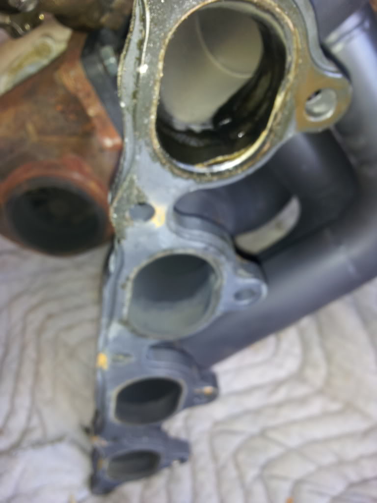

see that..

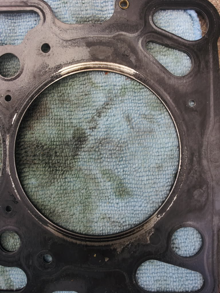

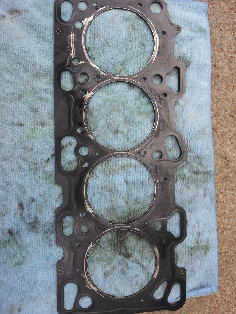

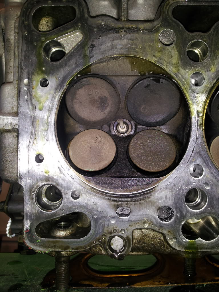

head gasket (head side, block side looked fine)

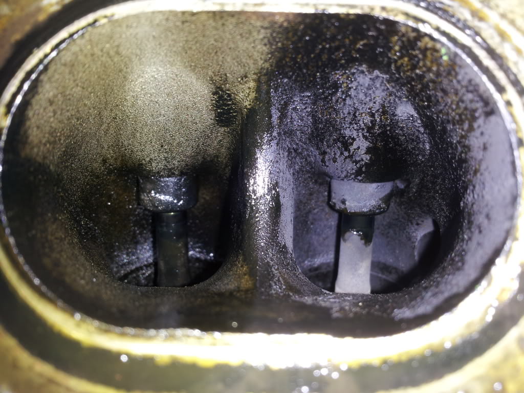

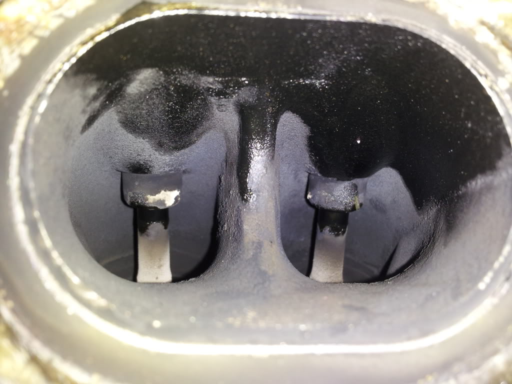

cyl. w/ the liquid in exhaust port:

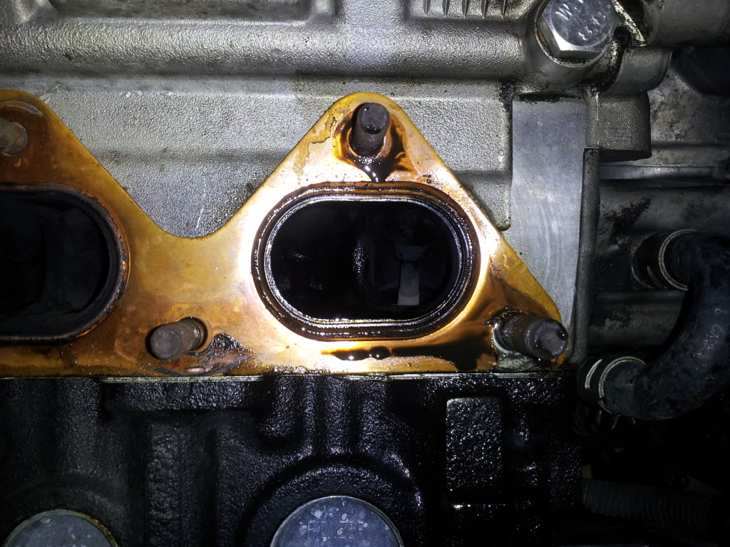

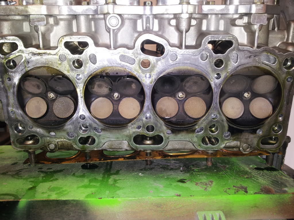

Head
the cyl w/ the most liquid in port
can see where it looks like it was pushing into that coolant passage... also that valve (bottom right) slightly discolored thats the exact port w/ the excessive liquid...

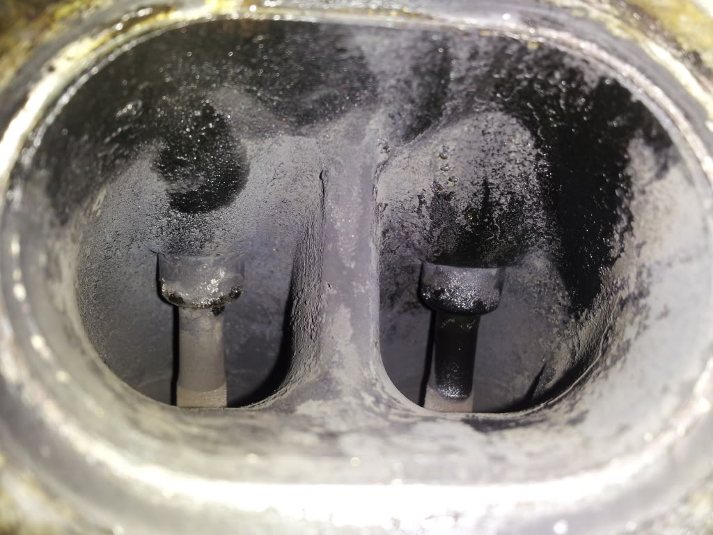

that port close up:

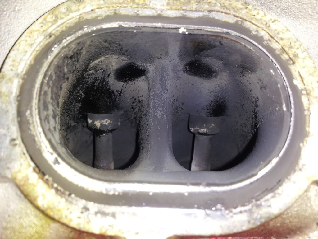

other exhaust ports in head:
looks like the head could use some new valve seals?
edit after thinking about it these are mostly probably from my gloves when i was lifting the head and moving it around

yea looks like the exhaust is getting into the coolant and while i was here i found that valve seal on that one port was tore...
to the machine shop she goes
