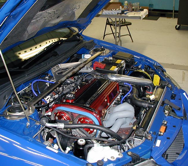

When you do replace them, use kevlar -- The kevlar belts are a bit difficult to initially install because they have very little give to them. They seem a bit loose at first but tighten up quickly by themselves after minimal engine run in. Be prepared for some extra underhood noise until the engine warms up.
