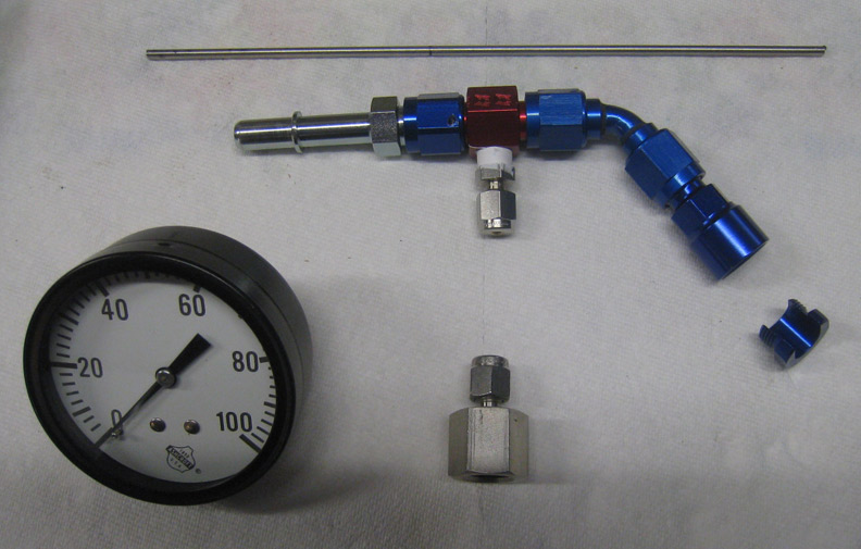

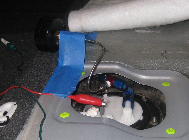

First set of pics below show the adapter I made up log fuel pressure. It just barely all fits in there. I had to tweak the 45 deg connector to get everything to line up. I would have loved to log outlet pressure using a pressure sensor, but it wasn't worth the cost of another sensor. I checked the accuracy of the gauge by starting the car, letting it warm up and then killing the motor. Fuel pressure holds high because the check valve in the pump outlet prevents pressure release. The gauge pressure matched the rail pressure of 43 psi pretty much exactly.

Adapter assembly to allow monitoring fuel pump outlet housing using stock fuel feed lines. The adapter that attaches to the pump housing is Russell PN 644120 (I had previously incorrectly listed it as 670340). Its sweet. They also make one with a -8 AN outlet.
Here's the installed adapter assembly. It just barely fit.

Oops. Correct PN for the quick connect that attaches to the pump carrier outlet is (3/8"): blue = 644120, and black = 644123
Also, if anyone wants to connect to the metal hardline, that is a different size (5/16"): blue = 644110, and black = 644113
