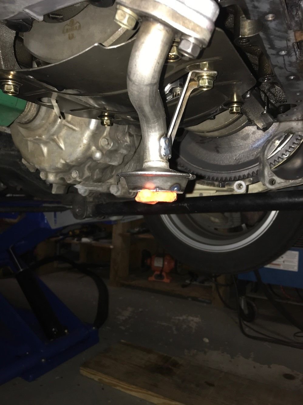

When I made my modified oil pan I also noticed the clearance was low, but that was partially due to the pan being modified. The stock gap with a new pan is ~0.100" from what I measured using Play-Doh. Buy a container of Play-Doh and ball it up on the end of the pickup tube and then press the pan flat to the engine and remove. You can then measure the thickness of the Play-Doy using some calipers to get a decent idea for the clearance. From what I read on the internet the typical recommended clearance is 1/4" so I shortened the end of the pickup to obtain the desired clearance. I am not sure it matters, but I kept the opening area the same as stock by first welding a piece of flat stainless plate to the pickup and then welding the original opening to the plate.
