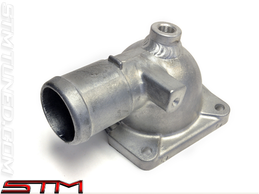

respect for craftmanship but stm sells top part for $50 with bung welded in.
I like STM; I've used them several times for OEM parts and other stuff. They offer a great selection of parts and excellent customer service to boot. I didn't realize they sold a modded OEM thermostat housing top with a bung for a sender:
http://www.streettunedmotorsports.co...emp_sensor.htm
However, having the sender in the top half of the T-stat housing means your reading temps AFTER the thermostat. In the rare situation that the thermostat sticks closed, your coolant gauge will be reading cold/normal temps, while your engine will actually be massively overheating. Not what I wanted.
There is a very good reason Mitsubishi put their coolant temperature sensor in the BOTTOM of the thermostat housing, before the thermostat, and not after it.

^^makes sense of course.
