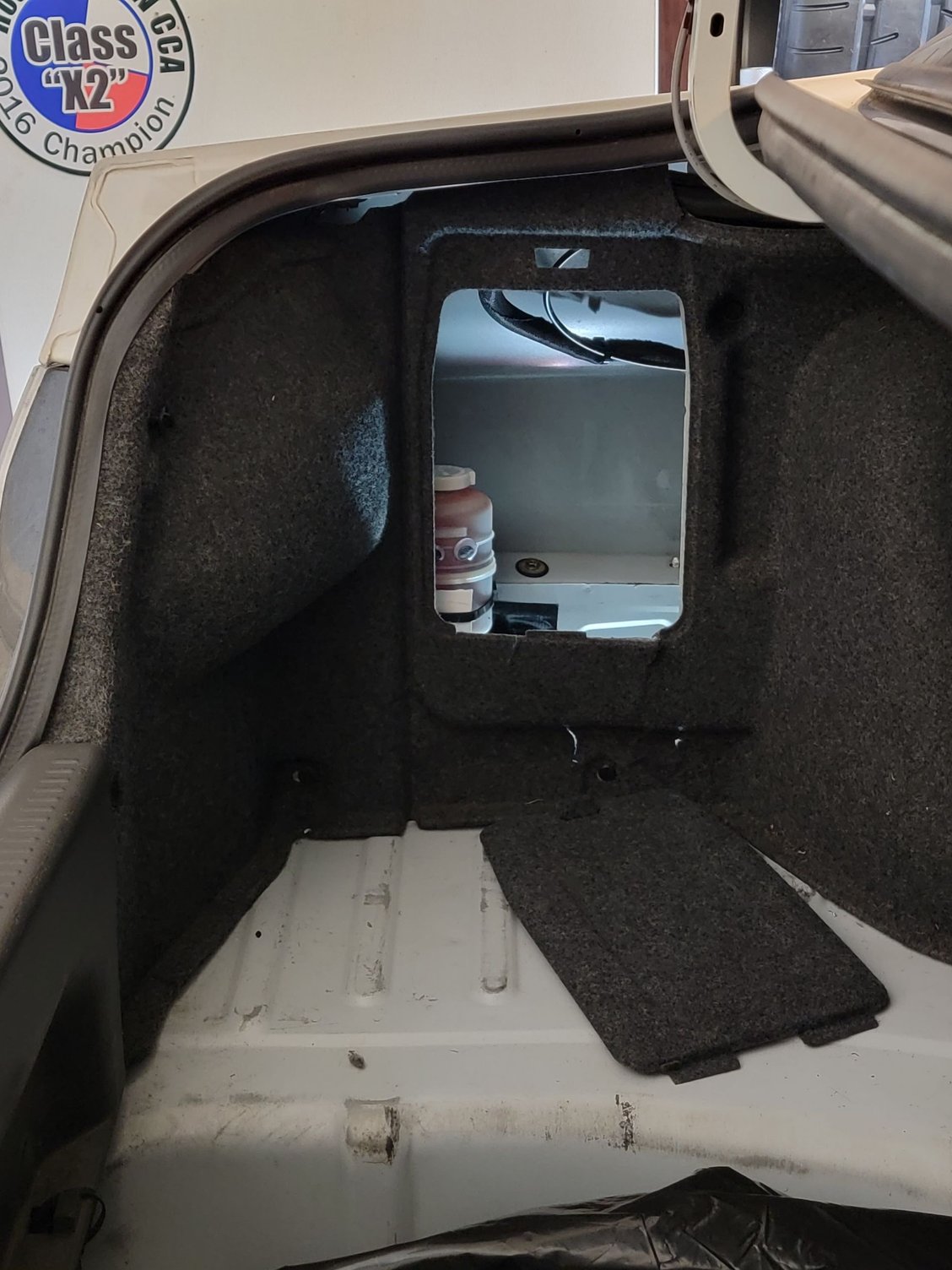

anyone know why this issue isn't normally addressed within the tank? it seems you only need to put the fuel pump assembly inside a container
any smart ideas @ayoustin ?
Not enough room.
Fuel Cell you can do a FCFST (Fuel Cell Fuel Surge Tank)

ok. maybe I'll skip some summer events to look in there thanks.
fuel pump assembly is in a container allready, from stock... Problem is that in left hand turns the fuel goes to the passenger side part of the tank and is pumped back only by a little suction off that T piece in the fuel return circuit.. adding an additional electric pump in the passenger side of the tank should fix most of the problems.. I actually made such a system, but due to issues with getting a car to test it on still have no results to show.. LOL
see here..>
