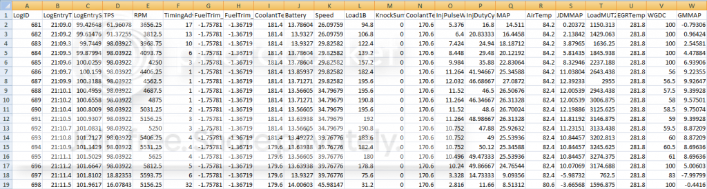

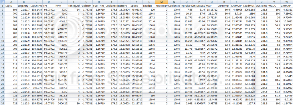

Old Aug 18, 2013 | 05:36 PM
wang4u's Avatar
Joined: Apr 2013
Posts: 148
From: Denver
Ok so here is the log. I think my tuner hasnt set my Omni 4Bar therefore the boost figures look off. I did test my gauge with wastegate pressure and turned it up from there. Seems pretty accurate thus far. With the Omni not possibly set, these logs almost seem useless..
2nd gear pull
3rd gear
