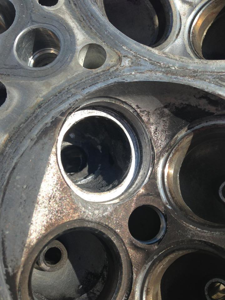

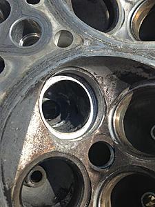

Hello, I am currently in the process of removing the head from my evo to see what the actual problem with my car is. the car began smoking while I was driving home and did a short pull, alot of smoke so I turned the car off and coasted into a parking lot, the car won't start. Attached is a picture of my spark plug on the left most cylinder when looking at the motor from the front of the car. With all 4 plugs removed when I look down into where the spark plug goes, the cylinder on the left side and the right side both have liquid when I look down the spark plug hole. I imagine that the motor is blown but I was wanting to see if anyone has had a similar issue. the spark plug on the left most cylinder is broken. Also a question that I have is should I purchase a short block from MAP or do you think it will be cheaper to have a local evo shop build my block with the same parts?
UPDATE: 4 October 2013
So I have pulled the head off of the car and Found a broken valve, so I took the head to the machine shop and they said it would be an easy fix but then when they took the valve out they saw that the port had been damaged by the metal which made a hole in the exhaust port. I just bought a bare head off of eBay and i'm going to use that since the my head is ruined. So now I have a few questions:
1. How does my bottom end look to you guys? I have 86,000 miles on stock bottom end and pics are attached
2. If my bottom end is good, should I re-use my stock head gasket or get a new one?
Attached Thumbnails Motor blown? broken spark plug-spark-plug.jpg   Motor blown? broken spark plug-exhaust-head2.jpg   Motor blown? broken spark plug-exhaust-head.jpg   Motor blown? broken spark plug-broken-head.jpg   Motor blown? broken spark plug-left-pistons.jpg

that dosnt look broken that looks like its melted from pre ignition
Old Sep 29, 2013 | 02:15 PM
slowsrt4:('s Avatar
Joined: Sep 2011
Posts: 1,288
From: JacksonvilleNorth Carolina/Central Florida
yeah I guess it is actually melted, I shouldn't have been doing a pull because my tune was off because when I tuned the car the turbo blew on the dyno and I hadn't been back to get a re-tune after I changed the turbo out. I know i'm an idiot...

Turn the motor over by hand a few times to see if it's blown. It should turn over relatively smooth with the plugs out. It looks like fuel that wasn't igniting.

Looks like you ran lean.
I hope all you did was melt a plug and pop the HG.
Check the pistons close for damage.

I had the same problem a while back I hate to say it but I think you melted a piston

Will I be able to know if I melted the piston by just removing the head?
Old Sep 30, 2013 | 01:40 PM
sktng22's Avatar
Posts: 722
From: Northern NJ
there would usually be a hole somewhere on the top of the piston so in most cases yes
Old Sep 30, 2013 | 03:57 PM
bubba17's Avatar
Joined: Aug 2011
Posts: 142
From: ohio
Removing the head it should be pretty obvious at that point you will either a have metal shavings over stuff or b a piston will have a hole in it or look dis functional
