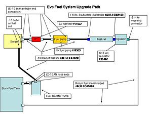

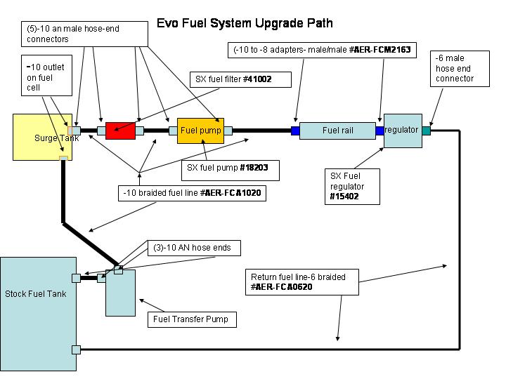

Got the brackets and everything made for the new fuel system. Here is a layout of it:

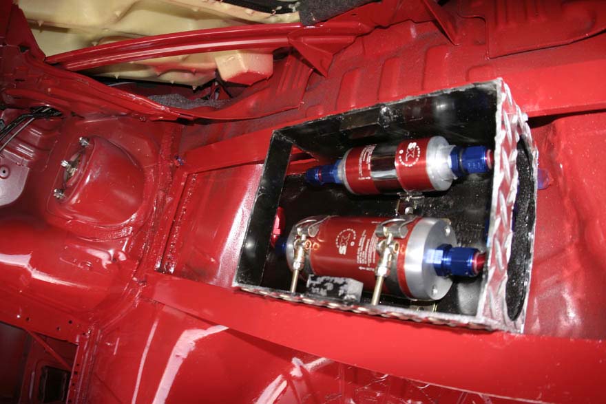

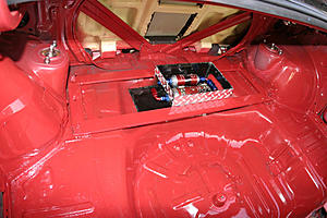

Install pic. I welded a steel base on each side of the trunk with 3 threaded studs on each. There is an aluminum bracket and thread plate pump and battery box on top of the base.

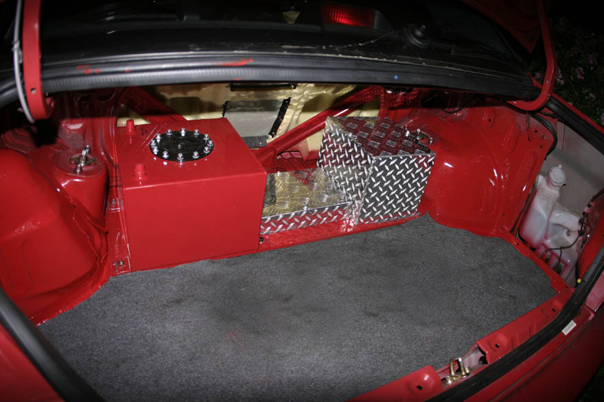

Here is a pic of the bracket.
The aluminum bracket sits on top of the base with the studs sticking through so that you can bolt/unbolt it. From there the fuel cell and battery box are bolted on top and the lines are run.

Last shot showing the sx fuel pump, filter and thread plate box which is welded to the bracket to make it more rigid:
