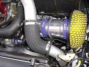

I had my HKS suction intake when I had the AEM installed. Since the AEM can work without the MAS, it was left out of the installtion (it's just another air flow blockage ). Anyway, without the MAS the filter ends up too close to ther intake horn so an spacer is needed. The first one was a straight piece of 4" dia aluminum tube. Very light and shiny, but it placed the filter in an awkward position....

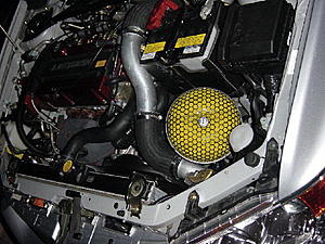

Another shot showing how the filter ended up jammed down into the space

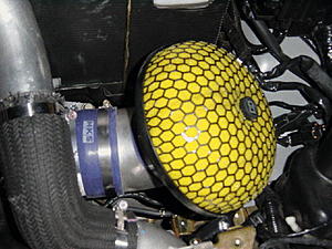

Anyway, I was not happy with the position of the filter so I went looking for a solution.... I found a 45° 4" dia bend and had it cut to what I guessed was a good length. I went to the car I tried it. Voila! it fit easily and well. Here is a picture..

Another shot of the filter at 45°

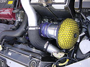

More pictres.....

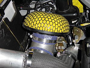

Anyway, the bend is made from steel. It's not as light as the aluminum for sure, but I doubt that it weights more than a few ounces. Aluminum would be nicer I think, but the price is very much higher....
