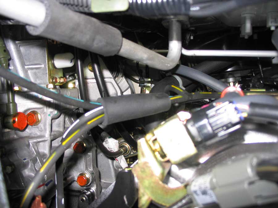

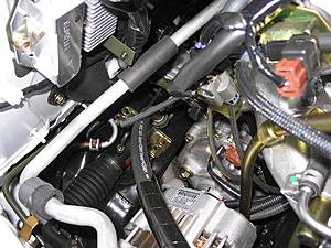

Guys, need your help! Throwing P0401 with just 100 miles..!!!!
I think my vacuum hose is off but it's the other end... those connected to EGR valve are
intact... but where are those hose should go?
Especially the one that point toward the passenger side wheel... I saw the disconnected
hose but no idea where it should go... !!
Please help!!!

this seems to be a common problem i had the same thing happen

Would anyone help me check? Where are those hose from EGR valve connect to??
I think mine popped off on the other end..

I found my hose flapping in the wind; put a dab of superglue around the nipple and zip tied it for extra insurance.

Turns out the EGR Vacuum Selenoid where the vaccum hose from EGR valve goes to
(the one pointing to passenger side wheel) is broken... the nipple where the hose is
suppose to connect to completely BROKE OFF!!!
