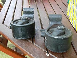

You sure on the engine side mount?
As I came across this pic of the mounts which does show them slightly different.

^ which one is which ?
I can't see any difference though
Old Sep 17, 2014 | 09:40 AM
Yogi_B's Avatar
Joined: Jul 2002
Posts: 630
From: Auckland, New Zealand
Evo4-6 on the right, evo7-9 on the left.
Maybe a bit hard to see at first but look at where the flat section of the mount is in relation to the bolt hole.
The evo4-6 mount has the flat section nearly inline with the bolt hole while the evo7-9 is much lower.
