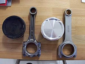

Hmmm, why go to 86mm? You won't gain much when it comes to engine volume by 1,0mm would you? If you then need to rebuild your engine for any reason you are out of over bores to use aren't you? And those pistons won't fit anyway as far as I understand from what people here has writen? Why not use the custom made 85,5mm EVO8 JE's from Buschur Racing?

Here is a pic comparing stock EVO6 piston and rod to the Eagle rod and JE piston bought from Buschur, not the best pic but you get an idea of the difference especially on the rod:
