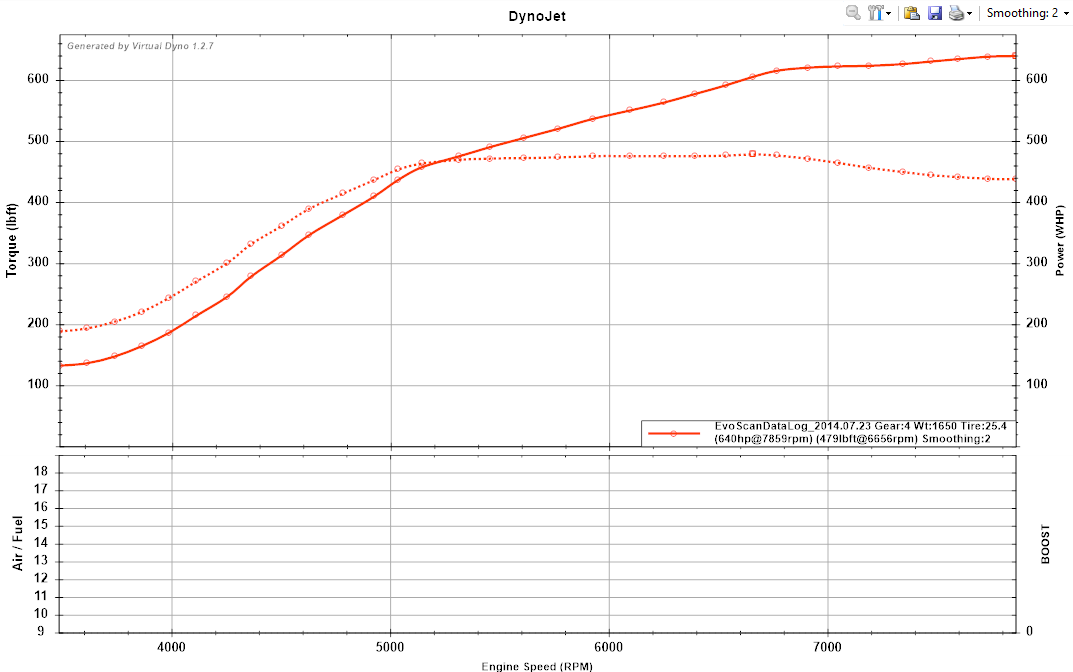

How much torque does the car make?
Old Apr 29, 2015 | 11:50 AM
KameloT's Avatar
Joined: Nov 2012
Posts: 65
From: Russia
On dynojet Virtual Dyno 479lbft
But really about 750nm, i think.

An ACT xtss should hold that. Theyre rated at 565ftlbs..
