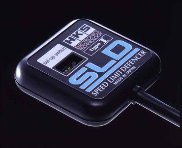

Pal, just go to your local speed shop and by the HKS SLD: Speed Limit Defencer.
That's it
Old Apr 18, 2004 | 08:11 AM
Crazy4Cars's Avatar
Posts: 563
From: Panama, Central America
here

IMHO, units from Pivot, Ultra or Blitz are better, because you can see the digital readout of the speed you're travelling.
I bet your speedo reading now maxes out at 180kmh. So when you're doing say 220kmh, you won't know without the digital readout.
Personally I'm going for the Greddy unit because it's the cheapest (only 6800Yen) and Evo8 already comes with 270kmh speedo so I don't need the digital readout.

Another option would be to use the Apexi Rev Speed Meter. That has a speed limiter defeater plus G-Tech type functions.
