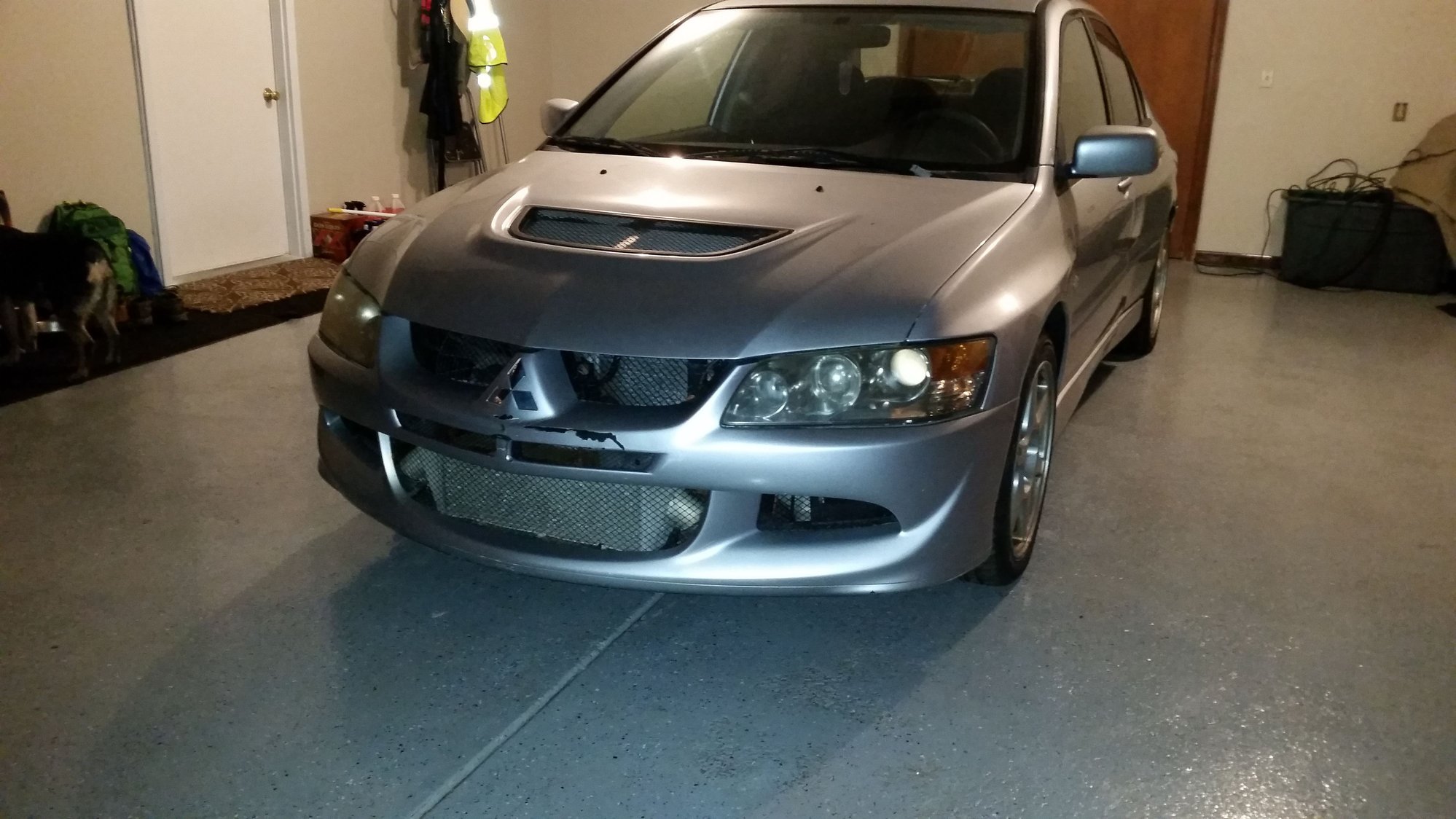

Hey guys and gals,
New to the Evo Scene.
Picked up a non running 03 Evo 8 for a steal earlier this month.
Owner didn't know what was wrong with it, just that it hadn't driven in a year.
Pulled the plugs and #2,3 & 4 are trashed.
The cylinder head and block are likely damaged. I haven't looked at the belt but I think it broke, hence the spark plug damage. Assuming this is an interference engine.
Anyways I'm pulling the engine in my garage with a cherry picker.
I'm finding it hard to find service info, (yes I've used the search tool).
Any advice on pulling the complete powertrain from the top?
Also any shops in the Michigan area that may have a 4G63 Longblock
or are experienced with Evo's?
Just want to restore the car to stock form for now.
My background: automotive engineer working in the Detroit metro area and self taught auto mechanic.
Pic below:
