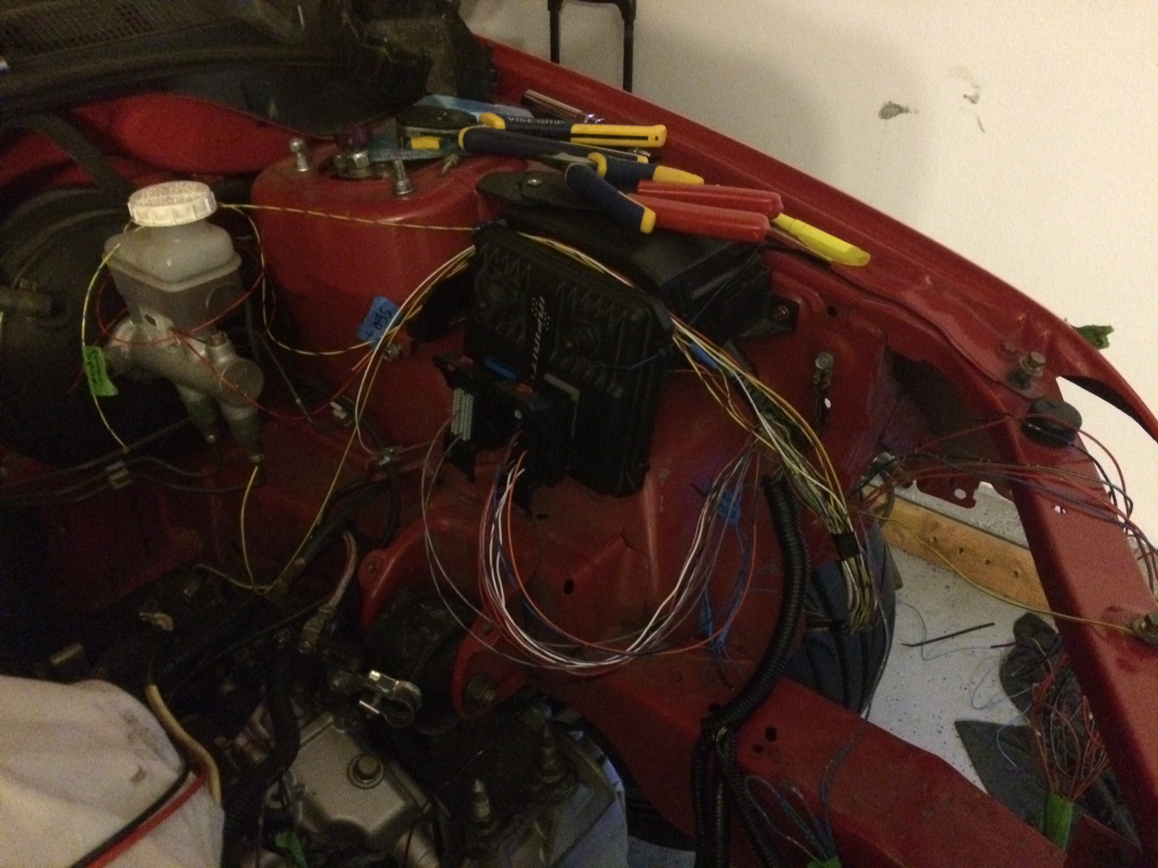

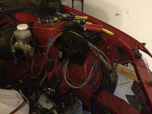

So now down to why it is better.
Crank and Cam trigger resolution. If you can trigger your ignition and fuel injection with greater accuracy you should make more power, and rev faster, and have a smoother running car.
Also if the ecu is weather proof you can mount it in your engine compartment
