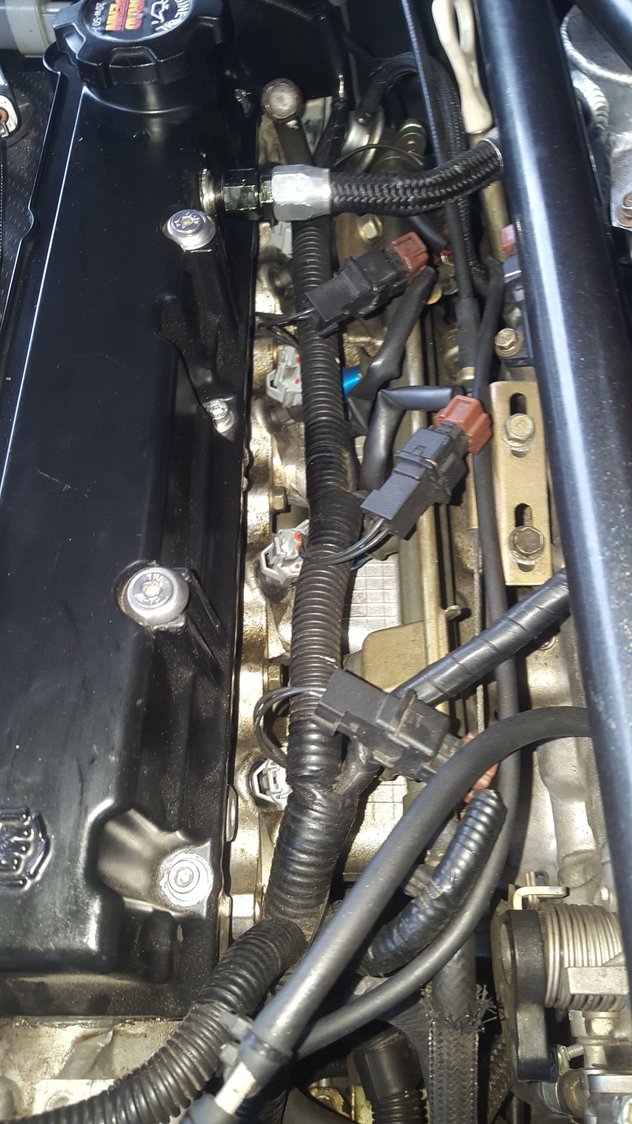

Lately I've been trying to diagnose and fix some oil leaks on my evo 9. One is around my oil cooler which I'm already trying to sort out but the one that confuses me is the oil I'm finding on top of the intake manifold. My best guess is its coming from the valve cover but a new gasket was installed a few months back along with the VC (purchased used from someone). I've used some SS bolts to install the VC and I notice when I go check to see if they are still tight, some are a little loose. I went ahead and reinstalled all VC bolts and added some loctite blue to see if that will prevent it from loosening up. I noticed my intake cam shield also has a small leak so I will be buying a new gasket for that tomorrow. The whole point of my post is to gain knowledge if it's possible the oil is coming from somewhere else? Here is a picture of what I'm talking about
This has been a little more oil from what I'm used to. Trying to diagnose and fix these issues on my own has been leading me to a dead end so I hope I can gain some more knowledge from you guys. Thank you

My catch can is the STM one which is VTA. haven't hit boost too hard lately so I've been keeping my spring off my dipstick and also because I'm checking my oil levels frequently. BOV is also VTA. So far I've cleaned it up since I made this post and its staying dry. I feel like it is coming from the VC, but maybe with the crank case pressure it is spewing past the gasket? My engine bay isn't splattered with oil when this happens if that information helps.

I just noticed this the other day as well. I dont have a catch can and no dipstick blow by. I also think it is coming from the valve cover gasket

VC gasket usually just leaks around the valve cover. Doesn't really spray/

Sorry just saw the pic closer up and that definitely isnt from bov spraying oil lol.
Like everyone is saying probably VC gasket or oil coming from some hose most likely induced by blow by.
