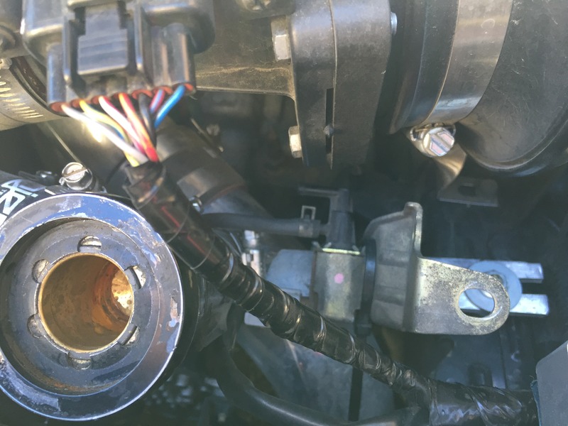

first pic is of a valve, I am not sure what it's for, but appears to be missing a vacuum line.

Actually in the second pic, what is the vacuum line doing? it doesn't seem to be doing anything.

Thanks I will get that checked out, but what about the BCS? and the missing vacuum line? or is that normal?

Missing vacuum line needs to go to intake manifold and what's BCS?

I think it's the boost control solenoid, the small part missing a vacuum line.
time to find a vacuum diagram, or repair manual with the diagrams.
