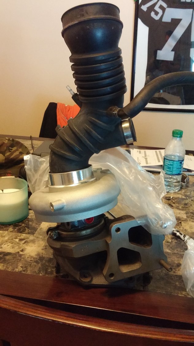

I just received an FP HTZ Green turbo (they upgraded my new MHI housing) that was supposed to have the stock compressor cover for this reason. When the turbo showed up, i opened the box to find this:
Obviously this isn't going to pass visual, especially with the inlet I'd need to use. FP apologized but said the only stock-sized covers they have are their logo cast onto them. So, I'd basically be stuck in the same boat. I guess if i'm going to have a non-stock appearing turbo, I may as well keep the FAP cover.
I then started thinking of options. One is to swap a stock turbo (that i don't have) back on for smog, though that would mean spending money on the junkiest one i can find. I'd have to lose oil (not the end of the world) and coolant (mine is $50/gal ). Then there is the mess. Obviously not the end of the world, but can I avoid it?
My next thought was to remove the Green tag and grind off the "FP" casting. "What about the stock inlet not fitting?" you ask? Well, this stays on really well and may work for smog LOL:
Am I willing to defile a brand new Green to pass smog? Yeah. Well, that and PD and CHP are still pulling over cars and popping hoods, so the turbo needs to look stock at all times. I'd even buy a C.A.R.B legal AEM intake.
So, here are pics of the turbo now. I'll post pics when I'm done. Mostly I'm posting in case i decide to sell the thing and nobody believes the turbo is what it is LOL.

Take the serial plate off, grind the FP logo flat, and get the AEM intake. You'll still have to use a reducer coupler for the AEM intake, but it will work.
I would keep the serial plate for future resale.
Hopefully that tricks the smog ****'s...
That's exactly what I'm thinking. The reducer/coupler will look like it came with the intake so no worries there. And I definitely planned to keep the plate. Even plan to take pictures before and after removal with a newspaper next to it. Like I'm holding it hostage LOL. I have an AEM sticker that I can put on anything. It's all printed up; I just need to stamp the "15" at the end of the CARB number. The only reason i consider that is because an AEM intake is ridiculously expensive and I hate feeling like I'm being robbed LOL
