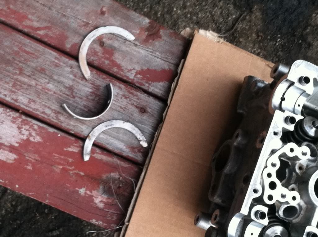

The 4G63's (7 Bolt) that are year 1997+ use the 3 piece "Split Washer" thrust bearing design.
Like this:

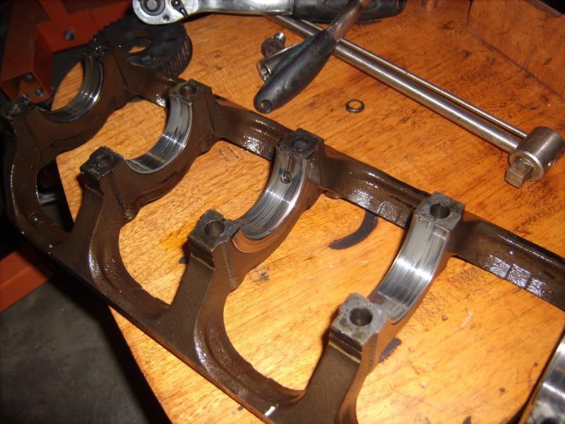

The Older 6 Bolt and "Pre 1997" 7 Bolt 4G63 motors use the "One Piece" Thrust washer design.
Like this:
The Problem with the old One Piece design is, when torquing the caps, the two "One Piece" thrusts can bind, and miss align, causing premature wear, and if there's a loss of oil pressure....well you know the rest.
If you have the older thrust washer design then you will need the One Piece thrust set. i do not think the Split Thrust set would work in that engine.
It would not work because of the main bearing cut out made for a One Piece Thrust on both the Block and Main Girdle.
The 3 Piece only has a cut for the Thrusts on the Block.
Unless the last owner somehow fitted a One piece thrust in a Post 97 4G63 (7 Bolt)
