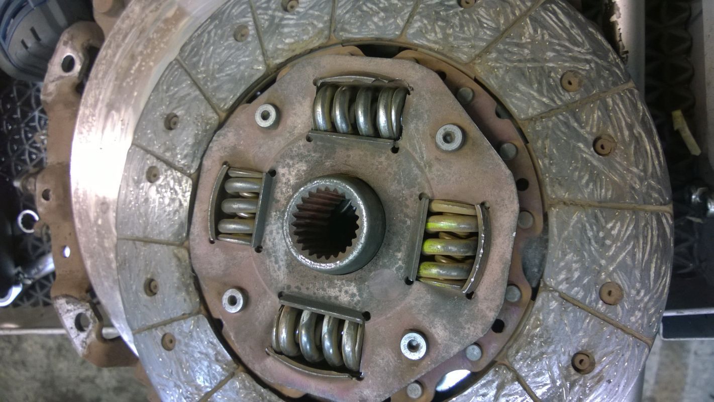

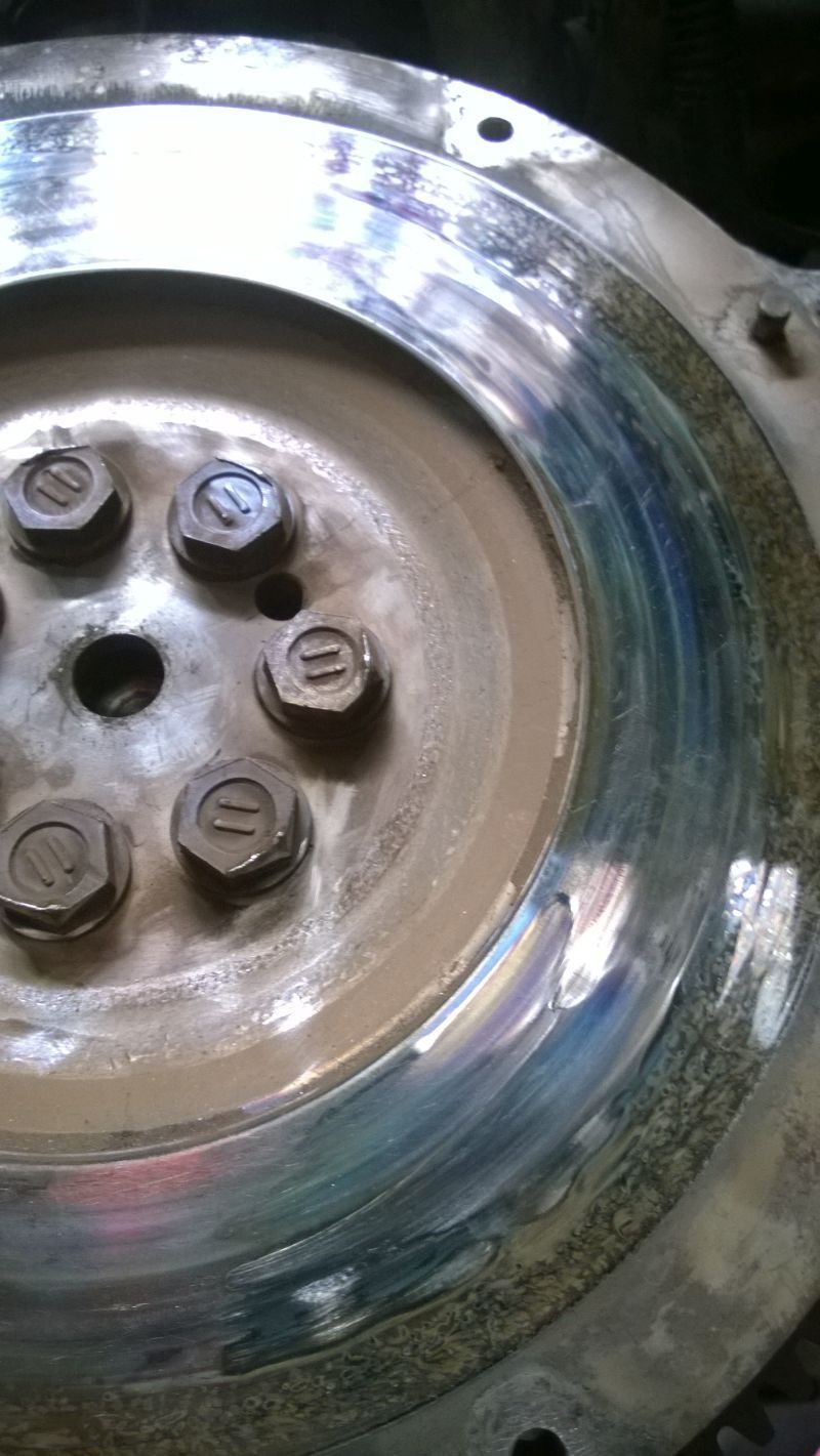

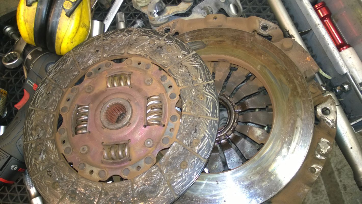

Got same symptoms when i got my first evo V last year. Next to impossible to get in gear when cold and standstill, once warm and moving no problems. Car shut off, all gears worked fine. When started cluth down, gear in car would jump little foward. Changed master clutch sylincer, no effect, bleeded, adjusted no effect.
Pulled tranny and found these.
Got new flywheel, clutch and pressure plate. No more problems.
Spring damage
Rounded bolts and heat marks
Ouch! But glad you were able to root cause it. I'm going to give the above adjustment one last chance and see if that fixes my issue. Otherwise I'll just pull the transmission as well. The clutch is 5 years old and has > 72,000 miles on it... it could be that something also finally broke. I know I still have the stock flywheel in there.
