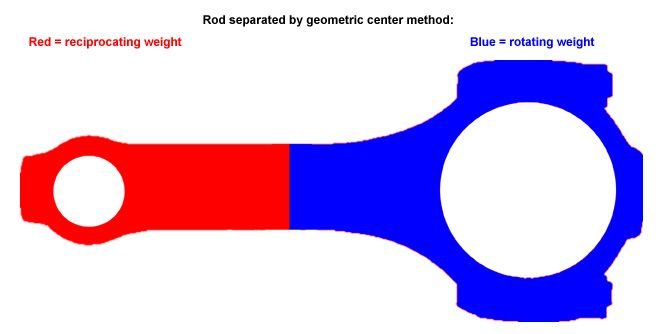

Connecting rods should be balanced with checking both reciprocating weight and rotating weight.
Like this:
How much is very subjective, guess it depends on what you will accept
I have seen so called balanced assemblies that had parts over 10 Grams different so I guess this is "acceptable" to some.
I balance to .5 gm per end & .5 total rod weight if possible.
You need some sort of arbor to find the center of the bores to weigh them correctly
The rod also has to hang level.
Hope this helps
Like this:
Hope this helps

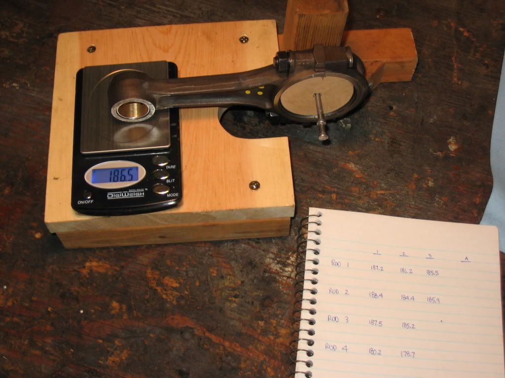

yes it has definitely helped! i didnt weigh the rods like you have, i dont have that jig.
i just put them on a scale and note down the numbers. i have another set of manley I beams with me and they all weigh within 5 grams, dont know what happened to these sets.
Just make your own.
Just make sure the rod is level.
