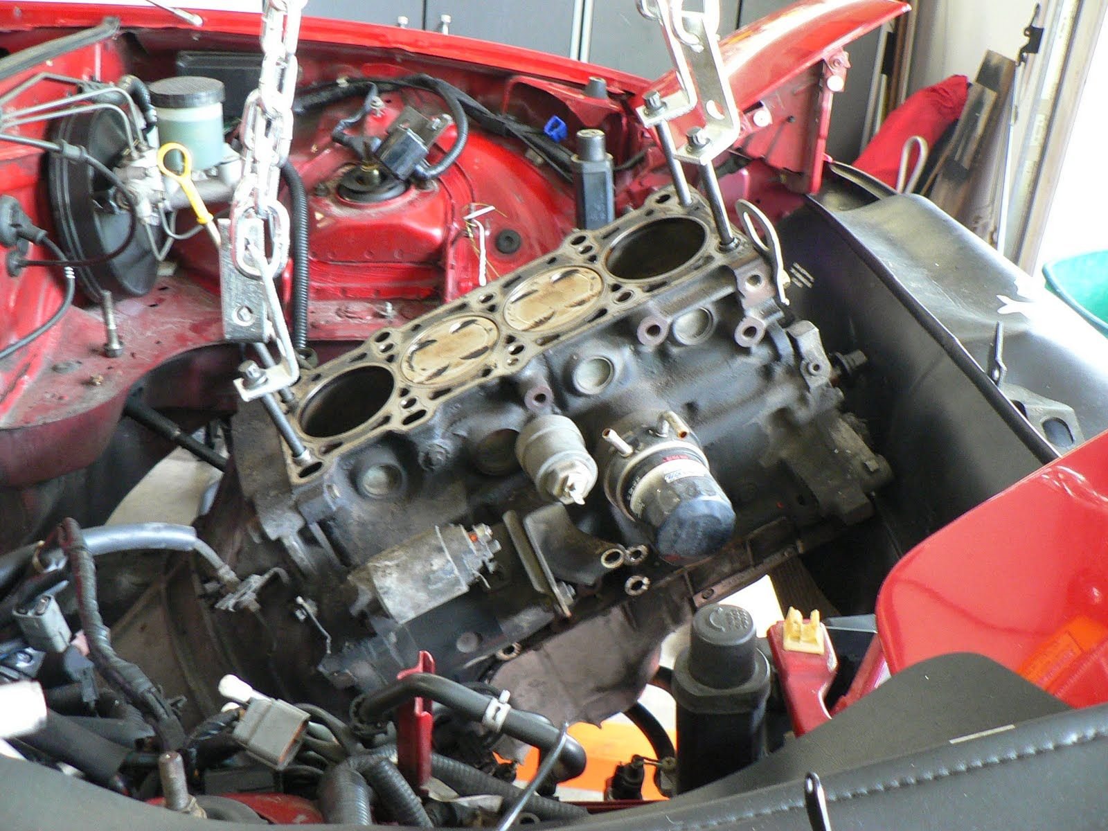

Something like this:

To add to Rom's suggestion. If you don't have those angled brackets you can just put the bolt through one of the links in the chain if it fits and use a large fender washer if the link is large. You use the old head bolts if they're available if that isn't obvious. Also, you can do it with just two bolts, just put them diagonally whichever way balances best.
