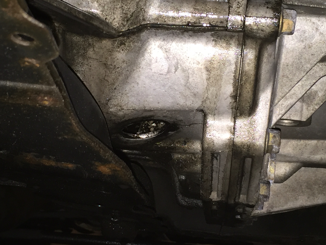

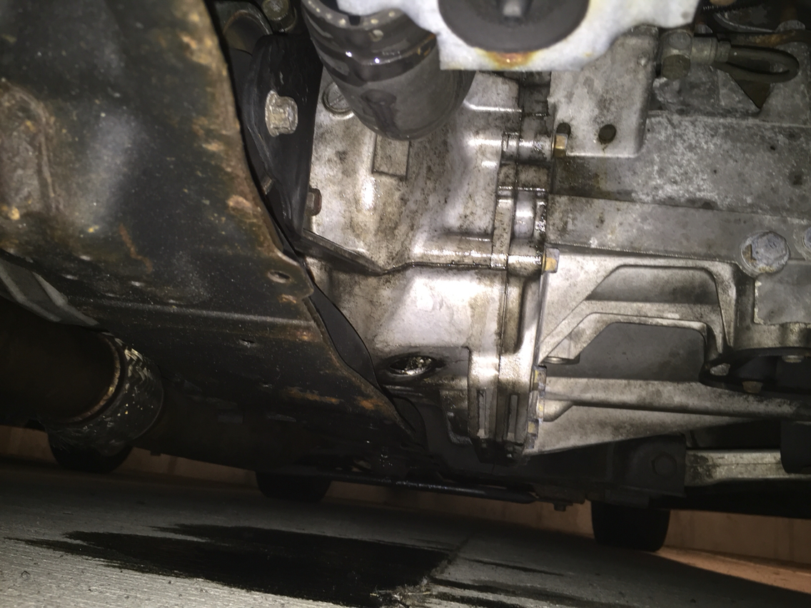

As the title says, I'm pretty sure my hdg6 from ACT exploded/disintegrated last night as I did a quick 2nd gear pull... Luckily I was across the street from my apartment so I pulled in and parked it to find a bunch of chunks taken out of the bell housing and oil dripping out of the trans Made for a bad day, but what can you do **** happens. On the plus side now I can send my trans/TC to TRE for a much needed build. Pictures to follow later this afternoon

Could be, all I know is it was bought and installed through MAP so it was professionally done, and I haven't beat on the car since I've had it and something in there blew apart. Once I get everything apart I'll know more, but since all the damage is inline with the clutch I'm thinking that's what it is

Here they are
Attached Thumbnails ACT clutch exploded?-photo62.jpg   ACT clutch exploded?-photo698.jpg   ACT clutch exploded?-photo398.jpg   ACT clutch exploded?-photo755.jpg
