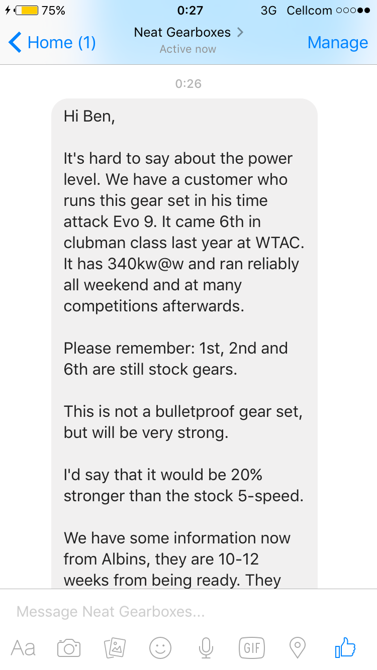

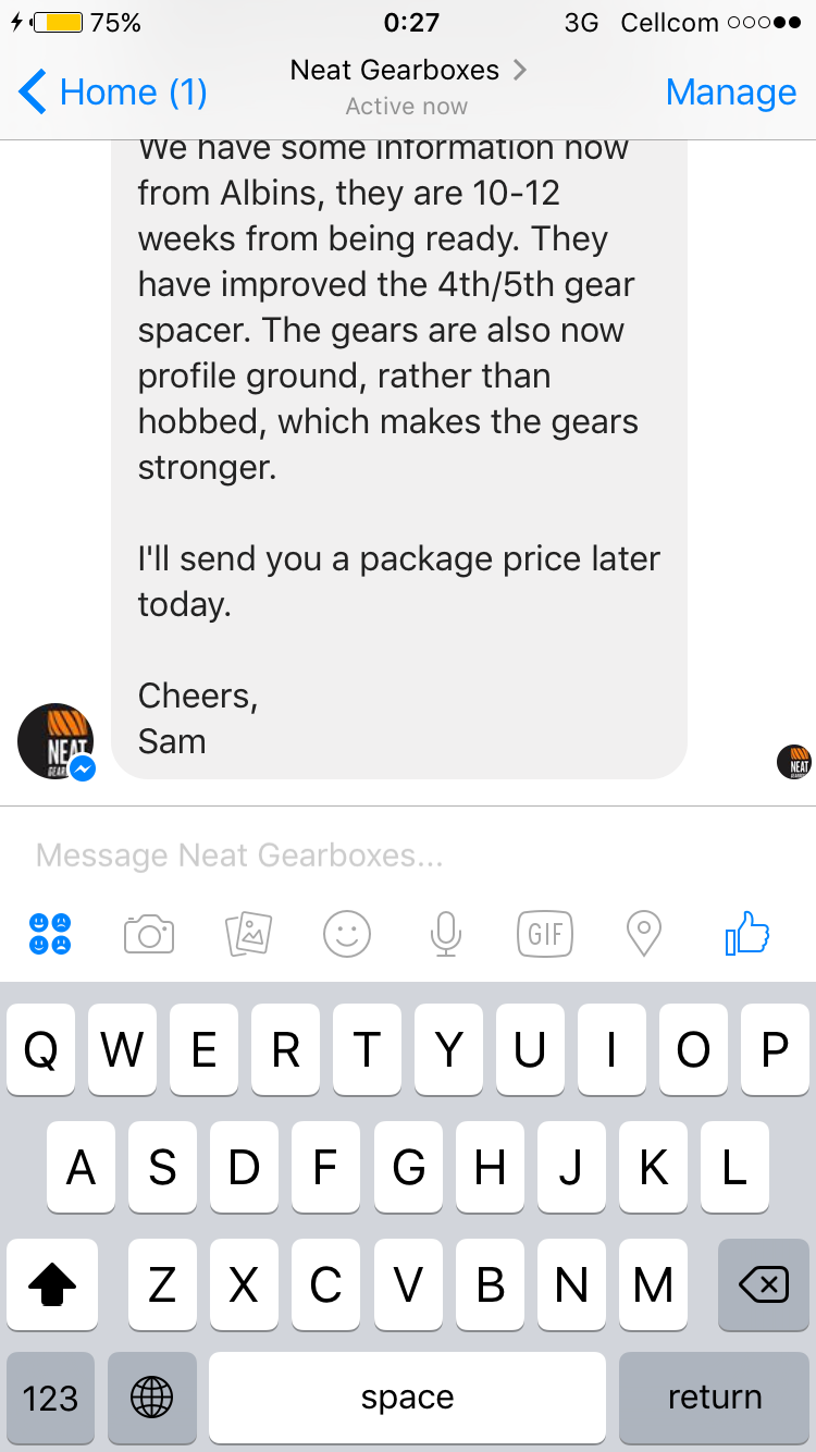

Just recive that from neat gearboxes!!

20% stronger than the stock 5 speed? Interesting... stock 5 speed designed for 360-390, so looking at 430+ on the low end.. not bad at all. may be the way to go if I ever get to that kind of power

Every year they improve this gearkit.. Maybe next year they'll reach 30% stronger
