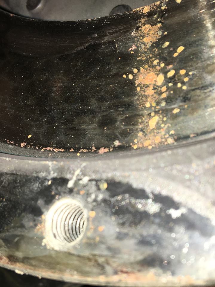

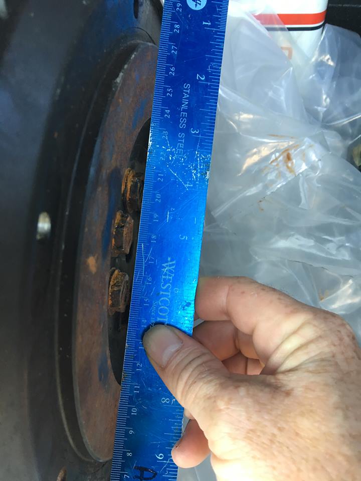

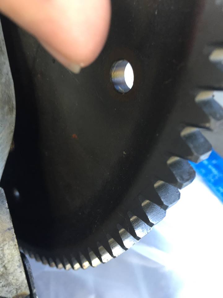

I just bought a new to me Evo IX MR and the engine is out of the car but the transmission and transfer case are still in the car. I guess he removed it like you would remove an engine from an automatic transmission. The car still has the Exedy Twin Plate in it and it looks like he removed the bolts from the back of the exedy flywheel that hold the "blocks" that you normally bolt the clutch cover to. The TOB is not even released right now.
Am I missing something? I didn't even know this was possible, and I'm wondering if whoever removed the engine screwed up the twin plate by doing it this way? When I look at the clutch that remains in the transmission the holes are threaded and the flywheel is not, it's more like a dowel rod hole.

Got it figured out, kind of. Still need to find which bolts connect the Exedy flywheel to the twin plate basket. Got the TOB released and removed the clutch basket. I had to get a third hand to press the clutch assembly and help compress the TOB to release it - took me a minute to figure out why I couldn't get the TOB to release.
Now I just need to identify which 6 bolts attach the clutch basket to the flywheel. Does anyone have a photo of the back of an Exedy Twin plate flywheel with the clutch assembly attached?
