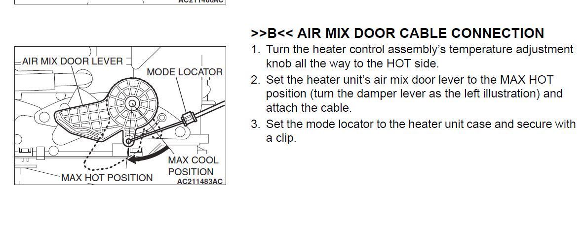

Check to ensure when the heater knob is at full hot the heat door lever is moving as well as noted here:

easy to access?
Thanks for the diagram.

easy to access?
you can reach your hand up under the dash and grab it to physically move it. Actually repairing it is a little more involved though.

interesting. Any insight on how to repair it if needed.?
Depends on what is wrong.
