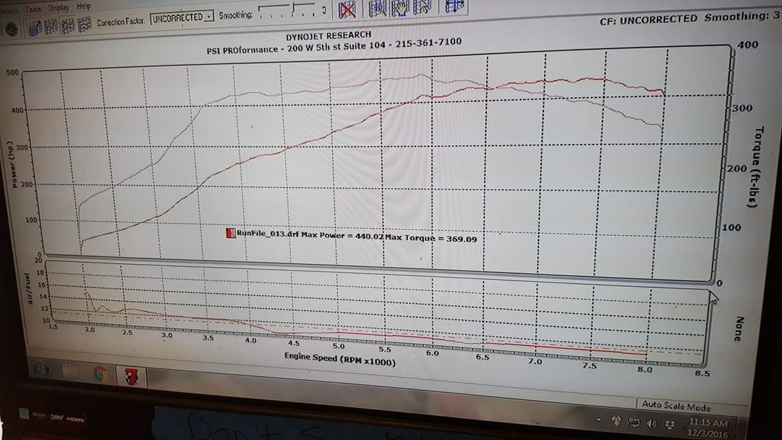

Not an FP turbo but my Blouch Dominator 1.0xtr on my Evo 8 with stock 86k mile block, stock head bolts, S2 cams and pump 93 fuel made 440 whp and 370 tq at 27.5-26 psi. I see 27 psi by 3800 rpm with the MHI housing. GREAT pump gas street setup.

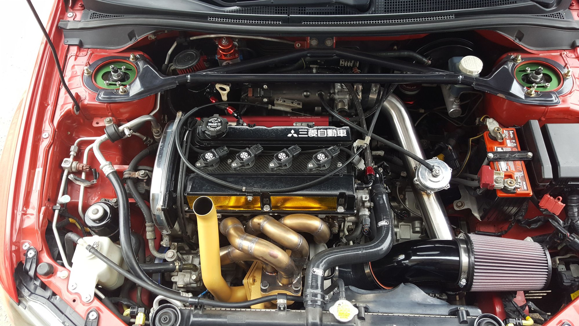

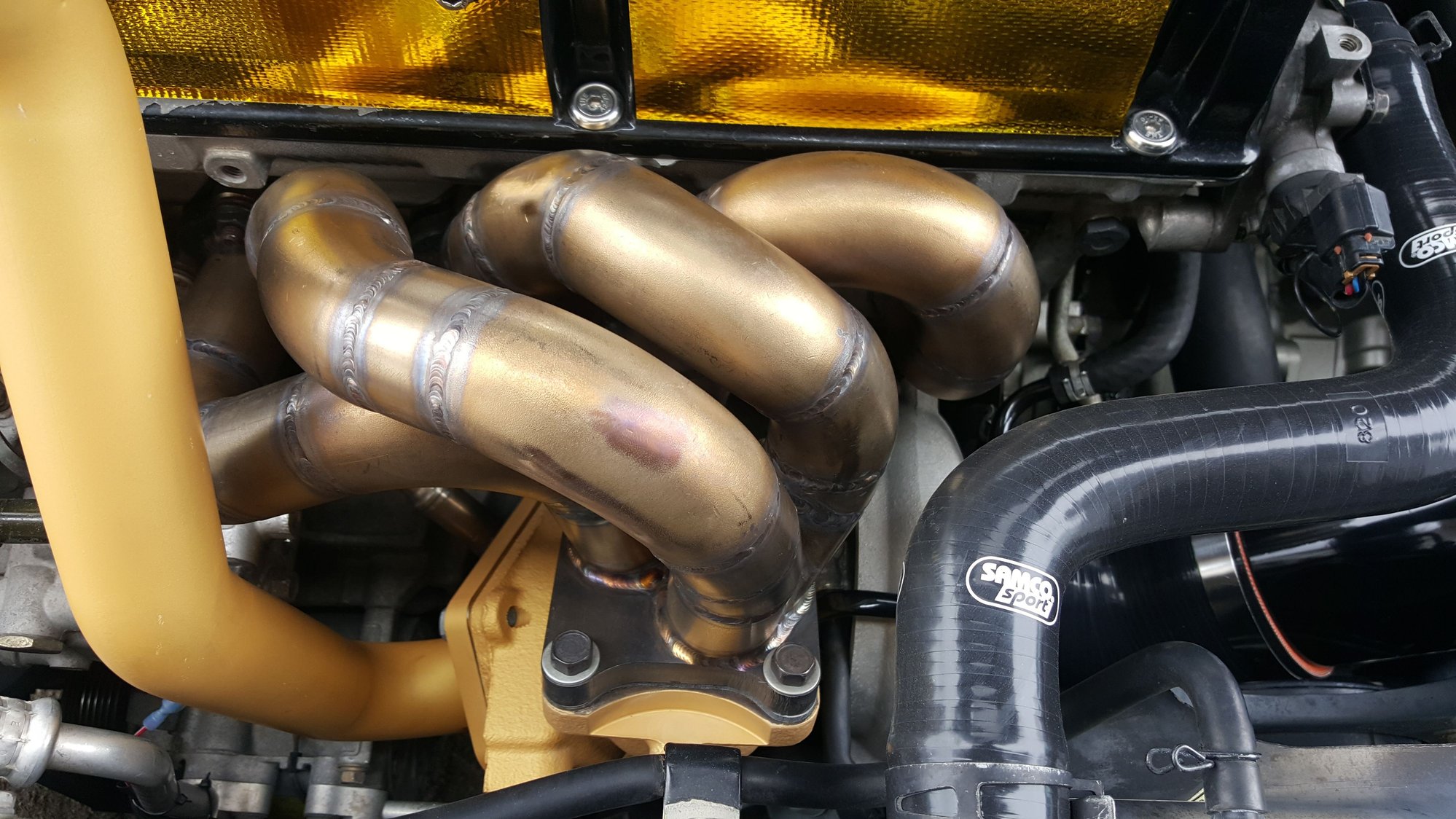

Could the torque issue be from the exhaust manifold we made? Or is the turbo getting lazy as I got it used. It is nice and tight. It's 1.25 twinscroll every transition is very smooth and close to equal length
