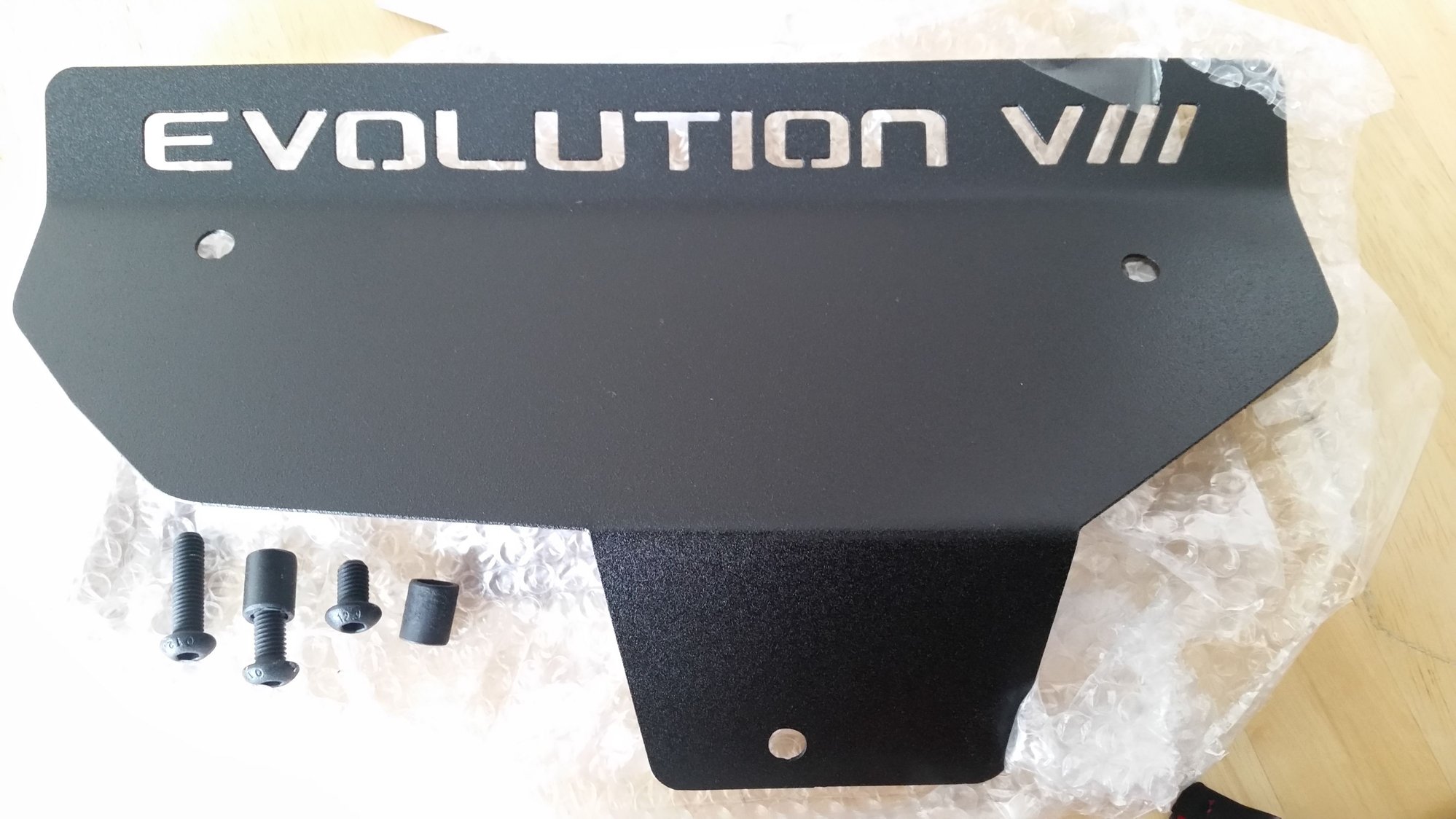

Simple yet elegant. Just arrived today. Will post pics of installment soon.

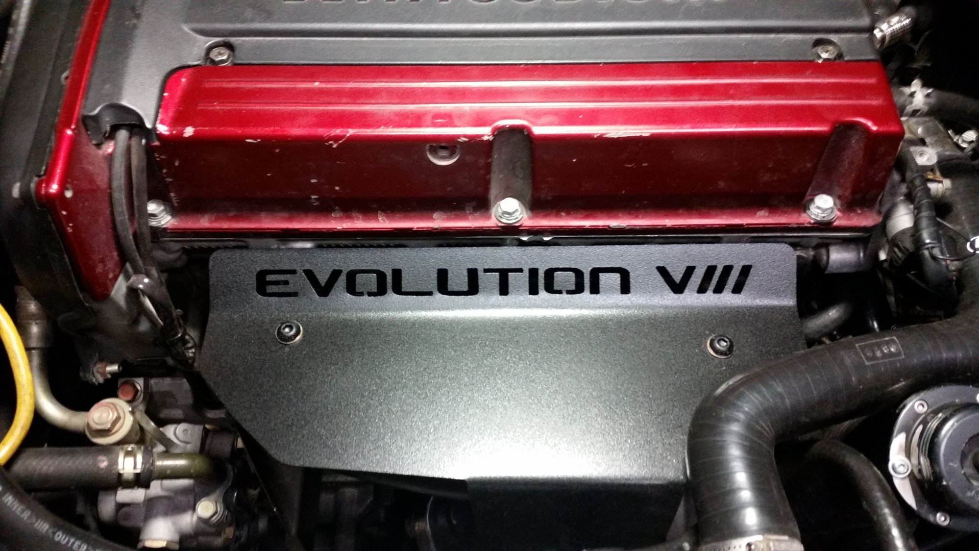

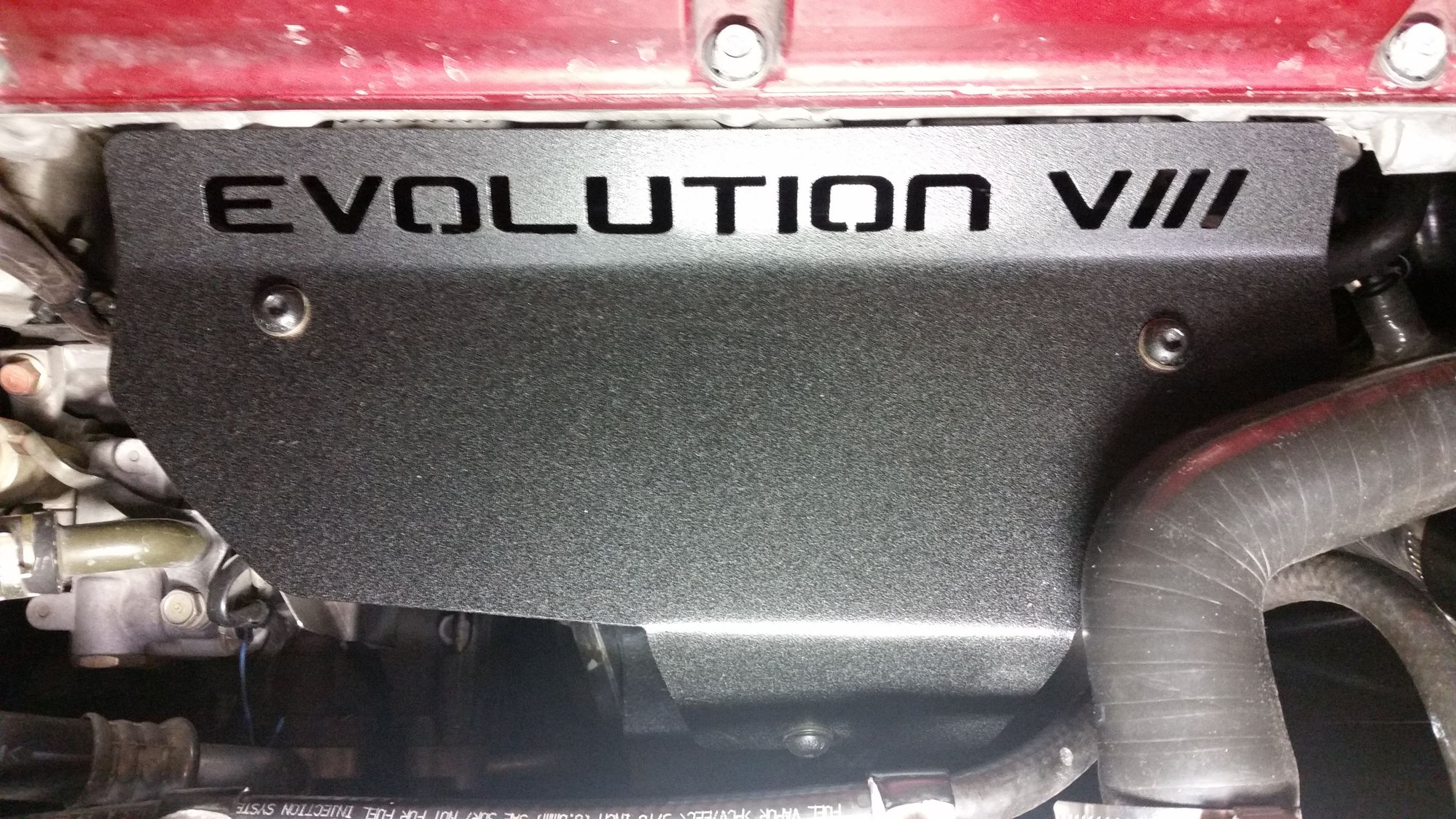

Installed. Easy, painless, and looks great. Did have to shape the front tab by the radiator, but like I said, look for your self.

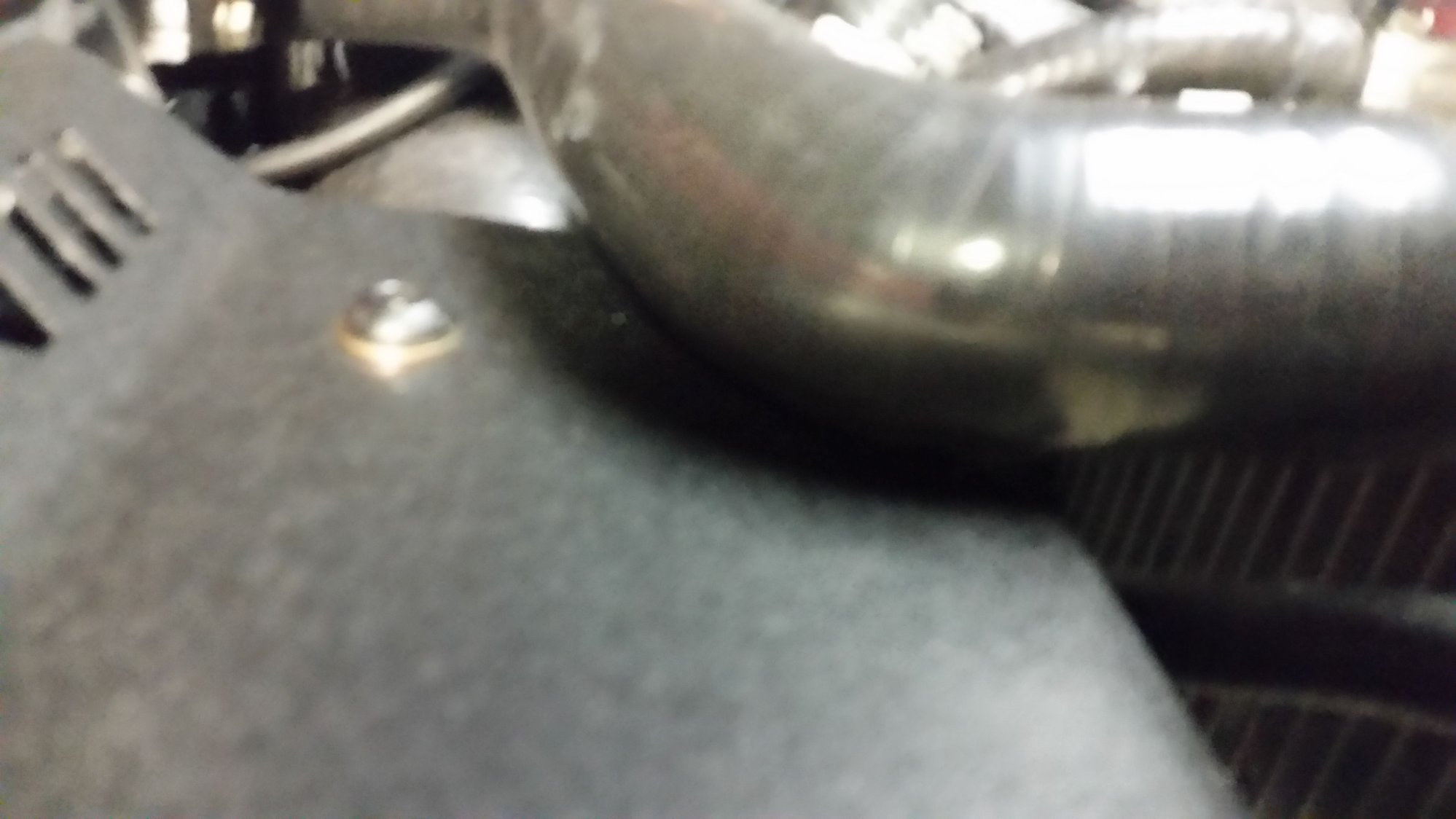

Here is a pic of the upper radiator hose. Mine rests on the shield slightly due to the BOV I am running and it pushes the upper radiator hose downward due to fitment. This may not happen with yours,

Not easy to see from the picture, but any clearance issue between upper radiator hose?
Also how necessary it would be to have some side (vertical) shields? Seems like this one is made of one sheet of metal without side coverage.
It does have more coverage than most aftermarket or JDM pieces near engine head side, which is good as we do not have anti-lag ports!
